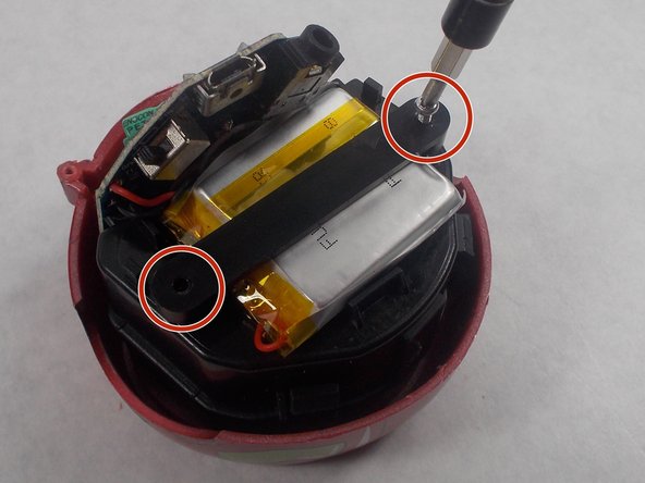

  8. Marvel iHome MR-M66 Battery Replacement: crwdns2935265:08crwdnd2935265:01crwdnd2935265:02crwdne2935265:0 Marvel iHome MR-M66 Battery Replacement: crwdns2935265:08crwdnd2935265:02crwdnd2935265:02crwdne2935265:0
    • Loosen and remove the two Phillips screws holding down the battery cover (the black plastic strip that keeps the battery in place).
