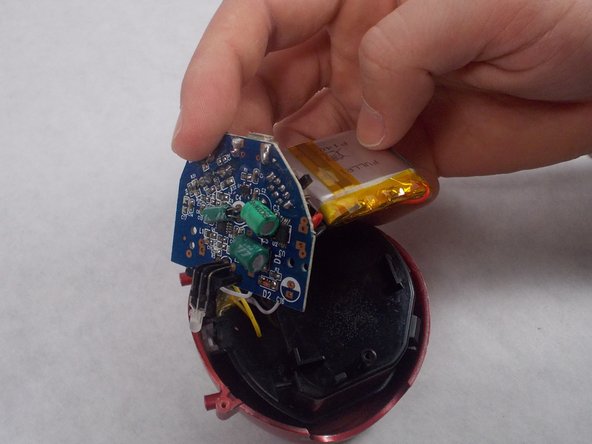

  7. Marvel iHome MR-M66 Auxiliary Port Replacement: crwdns2935265:07crwdnd2935265:01crwdnd2935265:02crwdne2935265:0 Marvel iHome MR-M66 Auxiliary Port Replacement: crwdns2935265:07crwdnd2935265:02crwdnd2935265:02crwdne2935265:0
    • Remove the two screws shown to release the circuitboard.
    • Gently remove both the battery and circuitboard.
    • They will be attached together by the battery's wires.

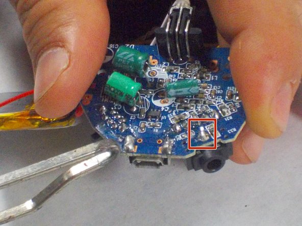

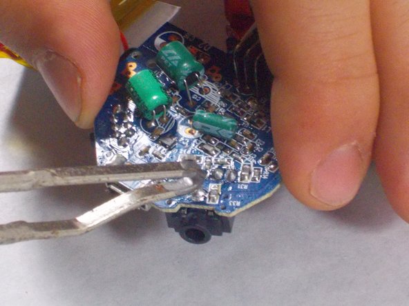

  8. Marvel iHome MR-M66 Auxiliary Port Replacement: crwdns2935265:08crwdnd2935265:01crwdnd2935265:03crwdne2935265:0 Marvel iHome MR-M66 Auxiliary Port Replacement: crwdns2935265:08crwdnd2935265:02crwdnd2935265:03crwdne2935265:0 Marvel iHome MR-M66 Auxiliary Port Replacement: crwdns2935265:08crwdnd2935265:03crwdnd2935265:03crwdne2935265:0
    • Locate the auxiliary port on the top side of the circuitboard.
    • On the bottom of the circuitboard, locate the metal pin connecting the auxiliary port to the circuitboard.
    • Use the soldering iron to disconnect the pin.
    • Use a pair of tweezers to remove the old auxiliary port.
    • Place the new auxiliary port in the same spot and solder the port to the circuitboard.
