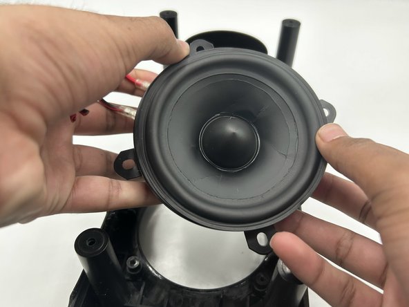

    • Remove the 3 mm Phillips #2 screws around the woofer.
  8. MartinLogan Motion 4i Woofer Replacement: crwdns2935265:08crwdnd2935265:01crwdnd2935265:01crwdne2935265:0
    • Lift the woofer out of the speaker base.

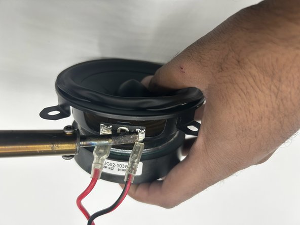

  9. MartinLogan Motion 4i Woofer Replacement: crwdns2935265:09crwdnd2935265:01crwdnd2935265:03crwdne2935265:0 MartinLogan Motion 4i Woofer Replacement: crwdns2935265:09crwdnd2935265:02crwdnd2935265:03crwdne2935265:0 MartinLogan Motion 4i Woofer Replacement: crwdns2935265:09crwdnd2935265:03crwdnd2935265:03crwdne2935265:0
    • Desolder the wires off the woofer.
