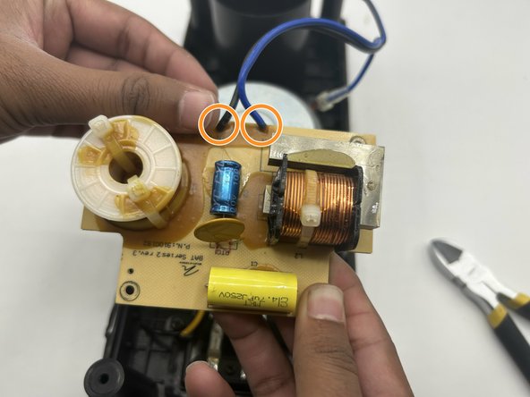

    • From this step onwards you will need a soldering iron, please read how to use one and be careful!
    • In order to access the tweeter, we must first remove the Crossover, which is highlighted in red.
    • Using the soldering iron, desolder the connections on both the blue and black wires.

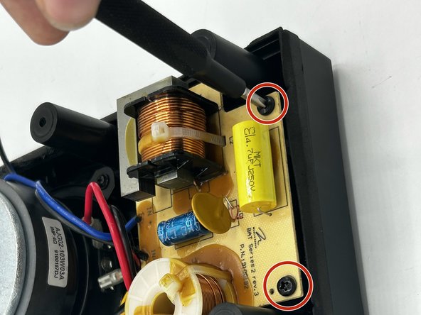

    • Remove the four 3 mm Phillips #2 screws found at the top of the crossover.
    • Remove the crossover from the speaker and set it aside.

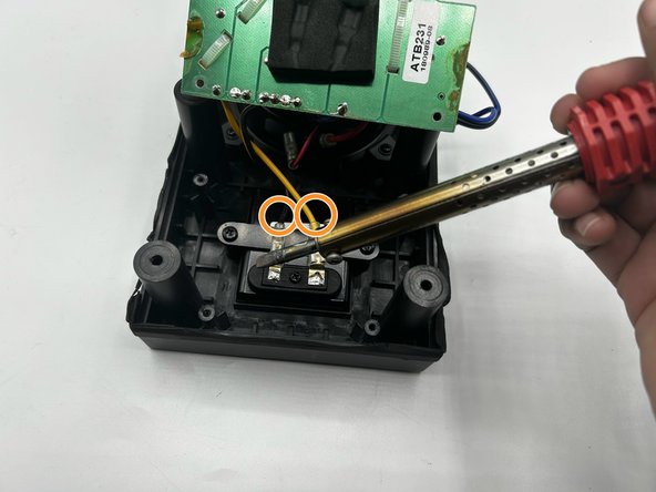

    • Unscrew the next three 3 mm Phillips #2 screws.
    • Desolder the connections on the black and yellow wires holding the tweeter in place.

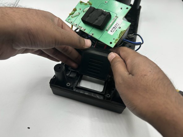

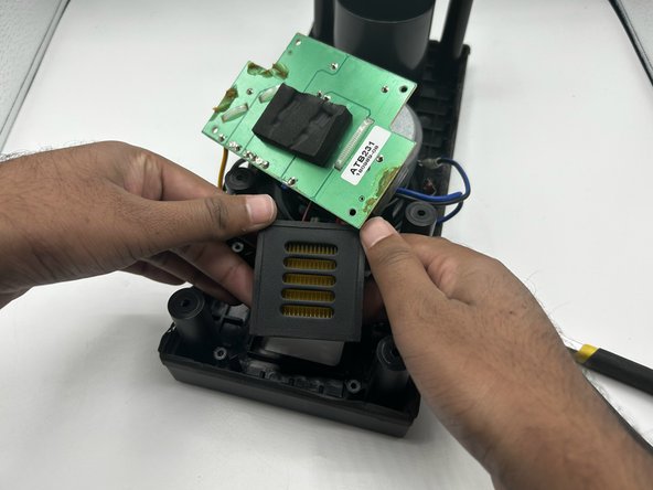

    • The tweeter should now be completely free. Give it a slight pull to remove it from the speaker.
