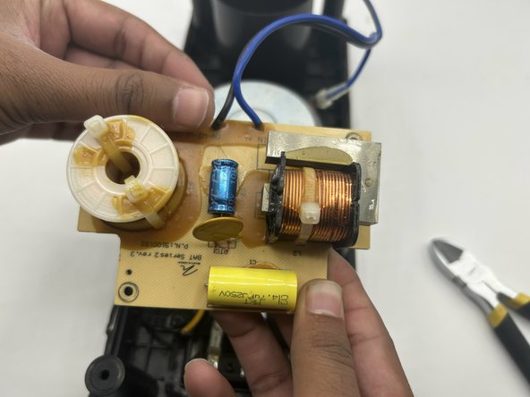

    • Remove both wires that are connecting the back of the speaker to the components of the speaker to fully access the speaker components.
  7. MartinLogan Motion 4i Crossover Replacement, Crossover: crwdns2935265:07crwdnd2935265:01crwdnd2935265:02crwdne2935265:0 MartinLogan Motion 4i Crossover Replacement, Crossover: crwdns2935265:07crwdnd2935265:02crwdnd2935265:02crwdne2935265:0
    • Remove the four 3 mm Phillips #2 screws found at the top of the crossover.
  8. MartinLogan Motion 4i Crossover Replacement: crwdns2935265:08crwdnd2935265:01crwdnd2935265:01crwdne2935265:0
    • Using the soldering iron, remove the solder from the connections that are holding the wires in place before removing the connections entirely.
    • When removing and replacing the crossover, use extra care when using the soldering iron. The iron is incredibly hot and can burn the user if it is not handled with care.
