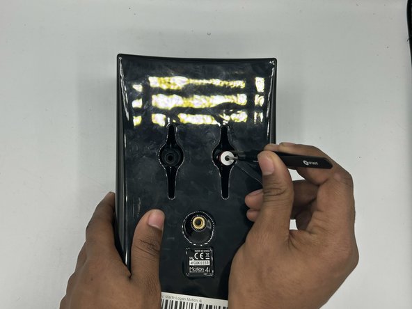

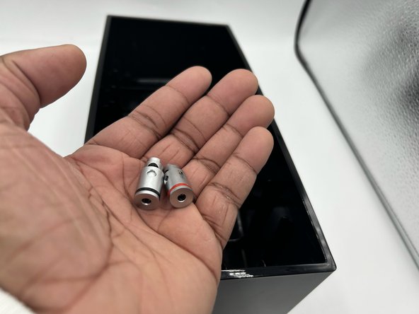

  7. MartinLogan Motion 4i Binding Post Replacement, Binding Post: crwdns2935265:07crwdnd2935265:01crwdnd2935265:03crwdne2935265:0 MartinLogan Motion 4i Binding Post Replacement, Binding Post: crwdns2935265:07crwdnd2935265:02crwdnd2935265:03crwdne2935265:0 MartinLogan Motion 4i Binding Post Replacement, Binding Post: crwdns2935265:07crwdnd2935265:03crwdnd2935265:03crwdne2935265:0
    • Use blunt ESD-safe tweezers to slowly move the binding posts back and forth to remove each of them.
    • You may need to give it a little more force than you need, however make sure that you pull straight up to make things easier.
