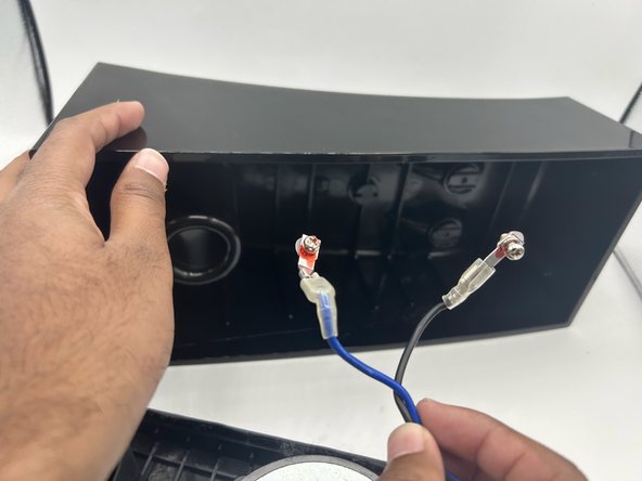

  6. MartinLogan Motion 4i Back Cover Replacement: crwdns2935265:06crwdnd2935265:01crwdnd2935265:02crwdne2935265:0 MartinLogan Motion 4i Back Cover Replacement: crwdns2935265:06crwdnd2935265:02crwdnd2935265:02crwdne2935265:0
    • Remove both wires that are connecting the back of the speaker to the components of the speaker to fully access the speaker components.
