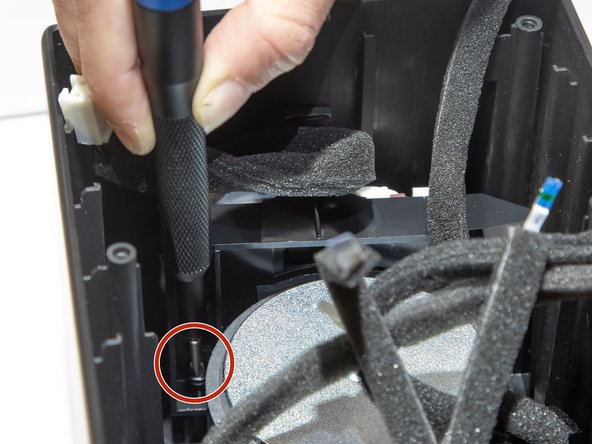

  4. Marshall Uxbridge Power Relay Replacement, Power Relay: crwdns2935265:04crwdnd2935265:01crwdnd2935265:02crwdne2935265:0 Marshall Uxbridge Power Relay Replacement, Power Relay: crwdns2935265:04crwdnd2935265:02crwdnd2935265:02crwdne2935265:0
    • Orient the bottom of the speaker to face away from you.
    • Use a Phillips #1 screwdriver to remove the two 12 mm screws holding the power relay in place.

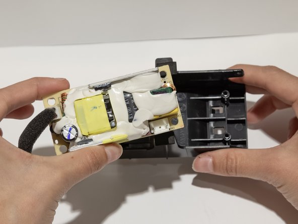

  5. Marshall Uxbridge Power Relay Replacement: crwdns2935265:05crwdnd2935265:01crwdnd2935265:01crwdne2935265:0
    • Separate the power relay from the speaker.
    • Slide out the blue ribbon cable from the power relay.
  6. Marshall Uxbridge Power Relay Replacement: crwdns2935265:06crwdnd2935265:01crwdnd2935265:02crwdne2935265:0 Marshall Uxbridge Power Relay Replacement: crwdns2935265:06crwdnd2935265:02crwdnd2935265:02crwdne2935265:0
    • Turn the power relay over to the other side.
    • Use a Phillips #000 screwdriver to remove the four 6 mm screws from the power relay.
