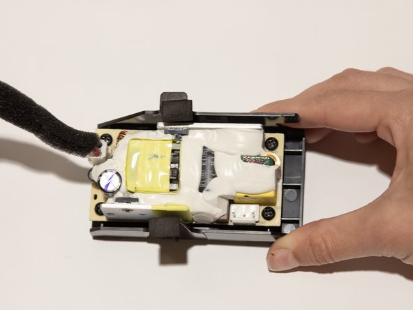

    • Orient the bottom of the speaker to face away from you.
    • Use a Phillips #1 screwdriver to remove the two 12 mm screws holding the power relay in place.
  5. Marshall Uxbridge LED Board Replacement: crwdns2935265:05crwdnd2935265:01crwdnd2935265:02crwdne2935265:0 Marshall Uxbridge LED Board Replacement: crwdns2935265:05crwdnd2935265:02crwdnd2935265:02crwdne2935265:0
    • Separate the power relay from the speaker.
    • Slide out the blue ribbon cable from the power relay.
    • Put the power relay to the side.

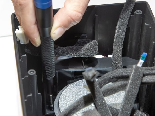

  6. Marshall Uxbridge LED Board Replacement: crwdns2935265:06crwdnd2935265:01crwdnd2935265:01crwdne2935265:0
    • Remove the two 6 mm screws connected to the LED board using a TR9 Torx screwdriver.
  7. Marshall Uxbridge LED Board Replacement: crwdns2935265:07crwdnd2935265:01crwdnd2935265:02crwdne2935265:0 Marshall Uxbridge LED Board Replacement: crwdns2935265:07crwdnd2935265:02crwdnd2935265:02crwdne2935265:0
    • Pull the blue ribbon cable to lift the LED board.
    • Pull the blue ribbon cable out of the LED board.
