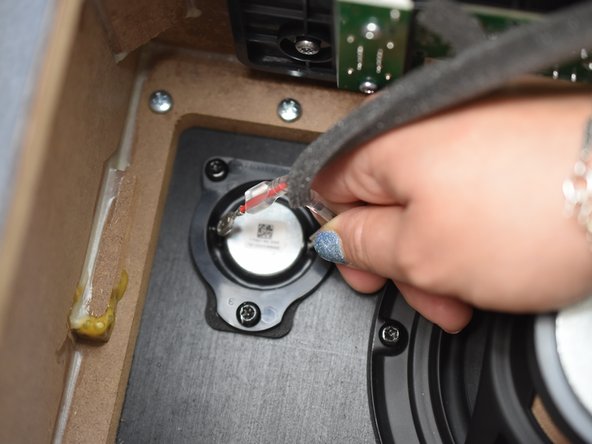

    1. Marshall Stanmore II Tweeter Assembly Replacement, Tweeter Assembly: crwdns2935265:04crwdnd2935265:01crwdnd2935265:02crwdne2935265:0 Marshall Stanmore II Tweeter Assembly Replacement, Tweeter Assembly: crwdns2935265:04crwdnd2935265:02crwdnd2935265:02crwdne2935265:0
      • Carefully pull back the translucent plastic sheathing on the two silver tweeter connectors.

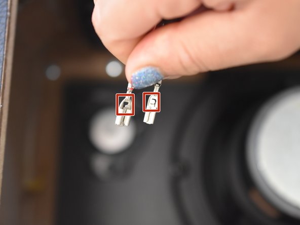

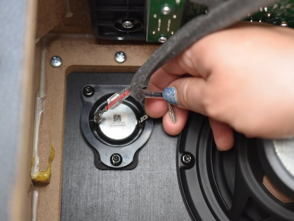

    2. Marshall Stanmore II Tweeter Assembly Replacement: crwdns2935265:05crwdnd2935265:01crwdnd2935265:03crwdne2935265:0 Marshall Stanmore II Tweeter Assembly Replacement: crwdns2935265:05crwdnd2935265:02crwdnd2935265:03crwdne2935265:0 Marshall Stanmore II Tweeter Assembly Replacement: crwdns2935265:05crwdnd2935265:03crwdnd2935265:03crwdne2935265:0
      • Using your fingernail or tweezers, apply precise pressure to the small latch in the middle of the connector and gently pull upwards to disconnect the connector.
      • Repeat for the second connector.

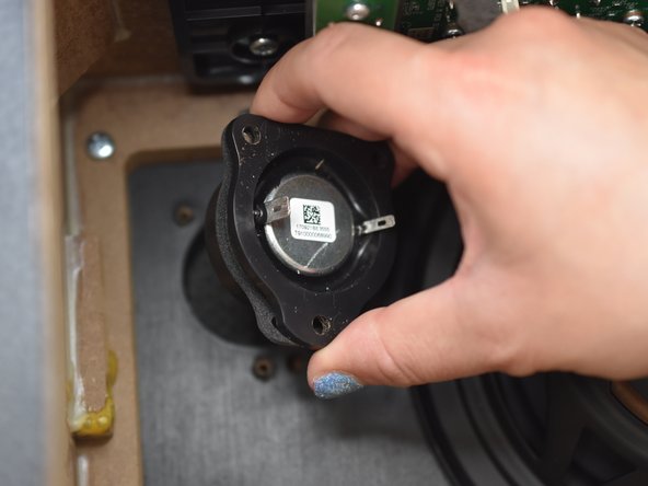

    3. Marshall Stanmore II Tweeter Assembly Replacement: crwdns2935265:06crwdnd2935265:01crwdnd2935265:02crwdne2935265:0 Marshall Stanmore II Tweeter Assembly Replacement: crwdns2935265:06crwdnd2935265:02crwdnd2935265:02crwdne2935265:0
      • Use a Torx T20 screwdriver to remove the three 20.5 mm screws that secure the tweeter.
      • Lift the tweeter assembly from its housing.
    4. Marshall Stanmore II Tweeter Assembly Replacement: crwdns2935265:07crwdnd2935265:01crwdnd2935265:01crwdne2935265:0
      • The felt seal is removable. If there is no seal on the tweeter, it may be stuck to the cutout on the speaker frame.
      • Repeat steps 4-6 to remove the second tweeter if necessary.
