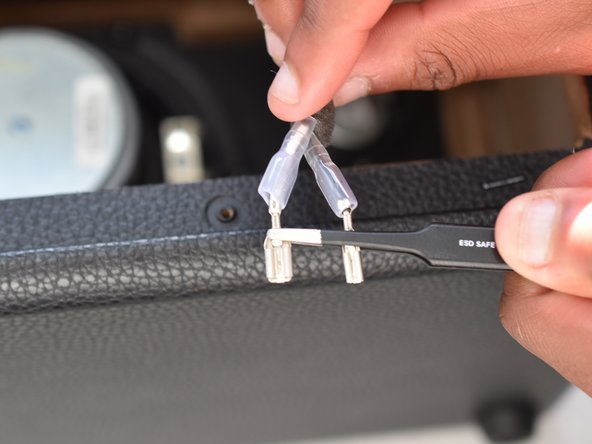

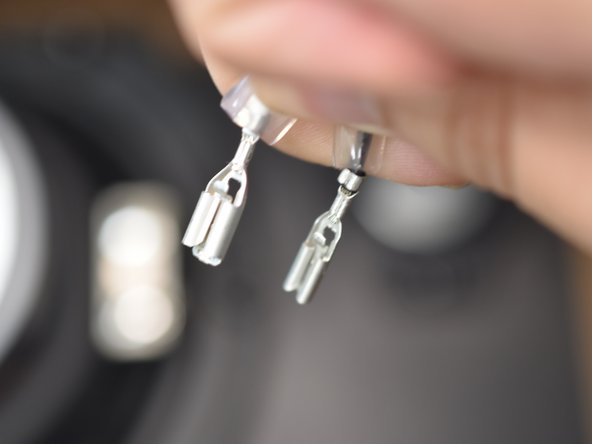

  4. Marshall Stanmore II Subwoofer Assembly Replacement, Subwoofer Assembly: crwdns2935265:04crwdnd2935265:01crwdnd2935265:03crwdne2935265:0 Marshall Stanmore II Subwoofer Assembly Replacement, Subwoofer Assembly: crwdns2935265:04crwdnd2935265:02crwdnd2935265:03crwdne2935265:0 Marshall Stanmore II Subwoofer Assembly Replacement, Subwoofer Assembly: crwdns2935265:04crwdnd2935265:03crwdnd2935265:03crwdne2935265:0
    • Pull back the clear sheaths on the end of each wire to expose the terminals.
    • Using a pair of tweezers, or your fingernail, depress the small latch and gently pull the wire off of the metal tabs.
    • Failure to press the latch while pulling could damage the subwoofer and/or wires.
