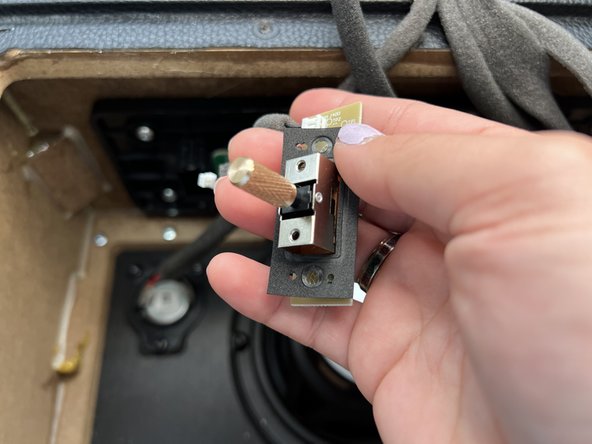

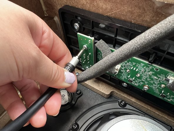

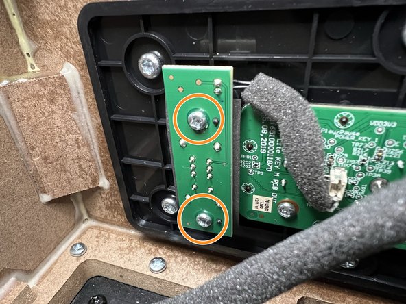

    1. Marshall Stanmore II Power Switch Replacement, Power Switch: crwdns2935265:04crwdnd2935265:01crwdnd2935265:03crwdne2935265:0 Marshall Stanmore II Power Switch Replacement, Power Switch: crwdns2935265:04crwdnd2935265:02crwdnd2935265:03crwdne2935265:0 Marshall Stanmore II Power Switch Replacement, Power Switch: crwdns2935265:04crwdnd2935265:03crwdnd2935265:03crwdne2935265:0
      • Locate the Power Switch PCB on the left-hand side above the subwoofer.
      • Use a Phillips #2 screwdriver to remove the two 10 mm screws that secure the PCB.
      • Because the space inside is somewhat cramped, consider using the iFixit 150 mm Flex Extension included in the iFixit Pro Tech Toolkit.

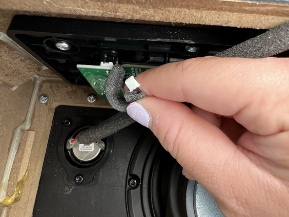

    2. Marshall Stanmore II Power Switch Replacement: crwdns2935265:05crwdnd2935265:01crwdnd2935265:02crwdne2935265:0 Marshall Stanmore II Power Switch Replacement: crwdns2935265:05crwdnd2935265:02crwdnd2935265:02crwdne2935265:0
      • Locate the PCB's black wire connector and gently disconnect it.
      • Do not pull on the wires.

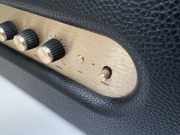

    3. Marshall Stanmore II Power Switch Replacement: crwdns2935265:06crwdnd2935265:01crwdnd2935265:03crwdne2935265:0 Marshall Stanmore II Power Switch Replacement: crwdns2935265:06crwdnd2935265:02crwdnd2935265:03crwdne2935265:0 Marshall Stanmore II Power Switch Replacement: crwdns2935265:06crwdnd2935265:03crwdnd2935265:03crwdne2935265:0
      • Pull the PCB out of the mount.
      • Take care not to damage the rubber seal surrounding the switch base as depicted in picture two.
      • Rocking the PCB back and forth while pulling may help remove the module.
