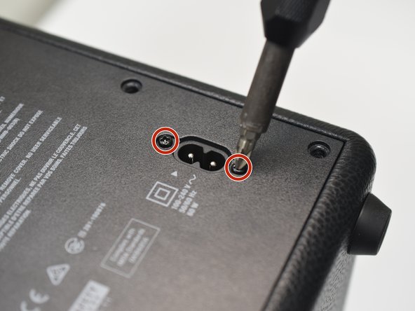

  4. Marshall Stanmore II Power Jack Replacement, Power Jack: crwdns2935265:04crwdnd2935265:01crwdnd2935265:02crwdne2935265:0 Marshall Stanmore II Power Jack Replacement, Power Jack: crwdns2935265:04crwdnd2935265:02crwdnd2935265:02crwdne2935265:0
    • Set the panel back in place.
    • Use a #1 Phillips screwdriver to remove the two 11.7 mm screws that secure the power jack.
    • When removed for the first time, the jack will remain in place until it is pulled out.

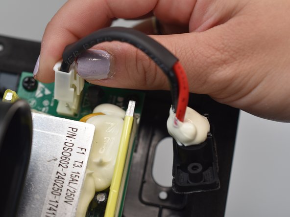

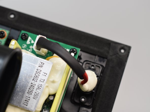

  5. Marshall Stanmore II Power Jack Replacement: crwdns2935265:05crwdnd2935265:01crwdnd2935265:02crwdne2935265:0 Marshall Stanmore II Power Jack Replacement: crwdns2935265:05crwdnd2935265:02crwdnd2935265:02crwdne2935265:0
    • Find the power jack cable inside of the removable panel. It is located in the upper, right corner of the panel interior.
  6. Marshall Stanmore II Power Jack Replacement: crwdns2935265:06crwdnd2935265:01crwdnd2935265:03crwdne2935265:0 Marshall Stanmore II Power Jack Replacement: crwdns2935265:06crwdnd2935265:02crwdnd2935265:03crwdne2935265:0 Marshall Stanmore II Power Jack Replacement: crwdns2935265:06crwdnd2935265:03crwdnd2935265:03crwdne2935265:0

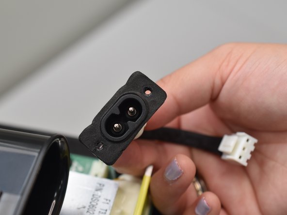

    • Depress the white plastic clip while pulling the connector up.
    • Remove the power jack.
