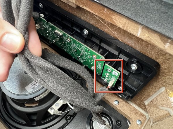

  4. Marshall Stanmore II AUX Board Replacement, AUX Board: crwdns2935265:04crwdnd2935265:01crwdnd2935265:02crwdne2935265:0 Marshall Stanmore II AUX Board Replacement, AUX Board: crwdns2935265:04crwdnd2935265:02crwdnd2935265:02crwdne2935265:0
    • Locate the AUX board on the right-hand side, above the subwoofer.

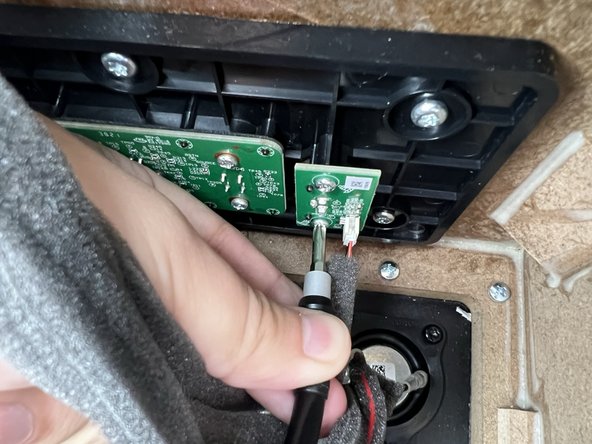

  5. Marshall Stanmore II AUX Board Replacement: crwdns2935265:05crwdnd2935265:01crwdnd2935265:02crwdne2935265:0 Marshall Stanmore II AUX Board Replacement: crwdns2935265:05crwdnd2935265:02crwdnd2935265:02crwdne2935265:0
    • Use a Phillips screwdriver to remove the two 9.6 mm screws that secure the AUX board to the speaker frame.
    • Since the screws are awkwardly located, using the 150 mm Flex Extension is recommended.

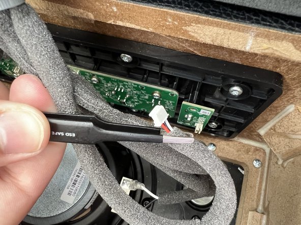

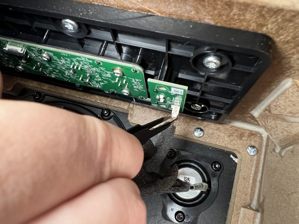

  6. Marshall Stanmore II AUX Board Replacement: crwdns2935265:06crwdnd2935265:01crwdnd2935265:03crwdne2935265:0 Marshall Stanmore II AUX Board Replacement: crwdns2935265:06crwdnd2935265:02crwdnd2935265:03crwdne2935265:0 Marshall Stanmore II AUX Board Replacement: crwdns2935265:06crwdnd2935265:03crwdnd2935265:03crwdne2935265:0
    • Disconnect the red and white cable connected to the AUX board by hand or with tweezers.
    • Do not pull on the wires.

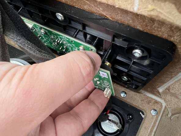

  7. Marshall Stanmore II AUX Board Replacement: crwdns2935265:07crwdnd2935265:01crwdnd2935265:03crwdne2935265:0 Marshall Stanmore II AUX Board Replacement: crwdns2935265:07crwdnd2935265:02crwdnd2935265:03crwdne2935265:0 Marshall Stanmore II AUX Board Replacement: crwdns2935265:07crwdnd2935265:03crwdnd2935265:03crwdne2935265:0

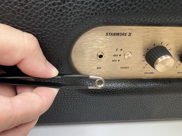

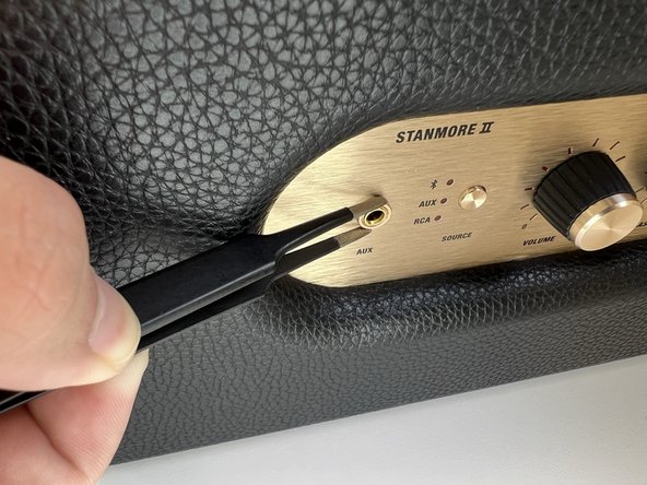

    • Turn the speaker around with the knobs facing you and unscrew the threaded washer that secures the AUX module to the outer plate.
    • The washer can be removed by hand or with tweezers.
    • Since it is disconnected from inside the frame, the AUX board may loosen enough to fall after removing the washer.

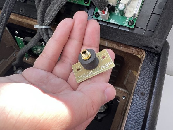

  8. Marshall Stanmore II AUX Board Replacement: crwdns2935265:08crwdnd2935265:01crwdnd2935265:03crwdne2935265:0 Marshall Stanmore II AUX Board Replacement: crwdns2935265:08crwdnd2935265:02crwdnd2935265:03crwdne2935265:0 Marshall Stanmore II AUX Board Replacement: crwdns2935265:08crwdnd2935265:03crwdnd2935265:03crwdne2935265:0
    • Remove the AUX board from inside the speaker.
