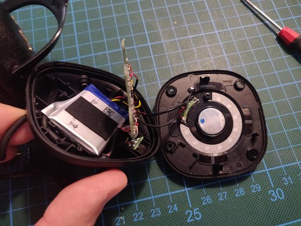

    • Twist off the ear cushion on the left side (the one with the button)
  2. Marshall MID bluetooth Headphones Battery Replacement: crwdns2935265:02crwdnd2935265:01crwdnd2935265:01crwdne2935265:0
    • Unscrew the 4 screws
  3. Marshall MID bluetooth Headphones Battery Replacement: crwdns2935265:03crwdnd2935265:01crwdnd2935265:02crwdne2935265:0 Marshall MID bluetooth Headphones Battery Replacement: crwdns2935265:03crwdnd2935265:02crwdnd2935265:02crwdne2935265:0
    • Unscrew the 3 screws holding the PCB in place

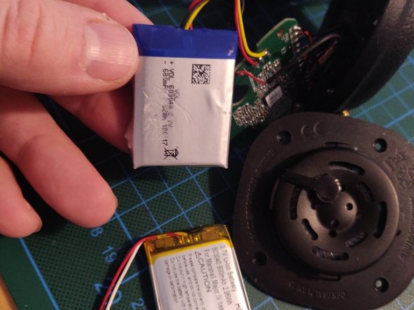

  4. Marshall MID bluetooth Headphones Battery Replacement: crwdns2935265:04crwdnd2935265:01crwdnd2935265:02crwdne2935265:0 Marshall MID bluetooth Headphones Battery Replacement: crwdns2935265:04crwdnd2935265:02crwdnd2935265:02crwdne2935265:0
    • Unseat the old battery, which is most likely taped to the bottom by double-sided sticky foam

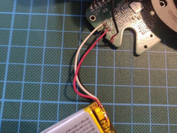

  5. Marshall MID bluetooth Headphones Battery Replacement: crwdns2935265:05crwdnd2935265:01crwdnd2935265:02crwdne2935265:0 Marshall MID bluetooth Headphones Battery Replacement: crwdns2935265:05crwdnd2935265:02crwdnd2935265:02crwdne2935265:0
    • Unsolder the 3 battery leads.
    • Solder the 3 leads from the new battery (red=B+, black=B-, white=NTC).
