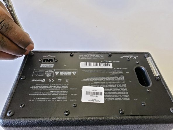

  4. Marshall Kilburn Main Speaker Replacement, Power Switch: crwdns2935265:04crwdnd2935265:01crwdnd2935265:03crwdne2935265:0 Marshall Kilburn Main Speaker Replacement, Power Switch: crwdns2935265:04crwdnd2935265:02crwdnd2935265:03crwdne2935265:0 Marshall Kilburn Main Speaker Replacement, Power Switch: crwdns2935265:04crwdnd2935265:03crwdnd2935265:03crwdne2935265:0
    • Place speaker as shown in image and remove the four corner 45.5mm back cover screws with a Phillips #2 driver.
    • Using a Phillips #2 driver, remove the six remaining 21.5mm outer back cover screws.

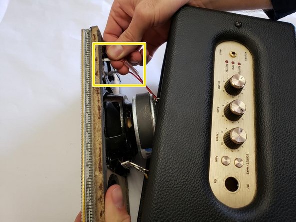

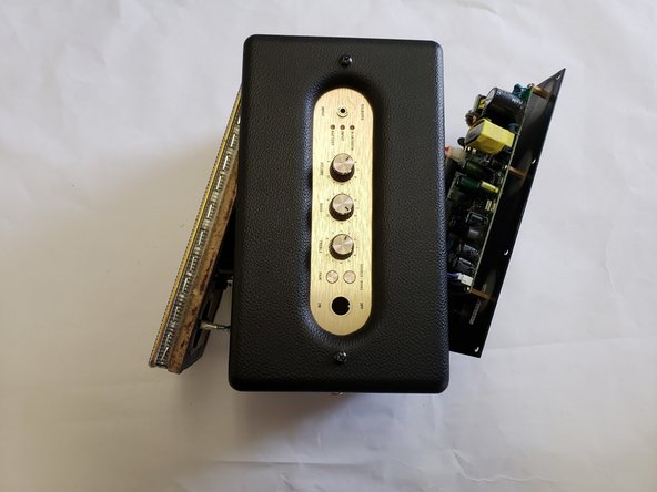

  5. Marshall Kilburn Main Speaker Replacement: crwdns2935265:05crwdnd2935265:01crwdnd2935265:02crwdne2935265:0 Marshall Kilburn Main Speaker Replacement: crwdns2935265:05crwdnd2935265:02crwdnd2935265:02crwdne2935265:0
    • Remove the back cover by using the vent hole as a grip.
    • Gently pull out the back cover and let it hang on the side of the speaker that has the knobs and power switch.
    • Unplug the main power lead from the control board; this allows the back to be opened more, allowing easy access to the power switch.

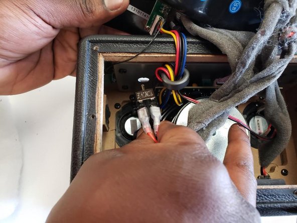

    • Place the speaker up right, and unscrew the golden bolt around the power switch with your hands, or a wrench.
    • Gently pull out the power switch as shown in the image.

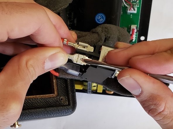

    • Use a slim spudger to wedge out the four red wires attached to the power switch.

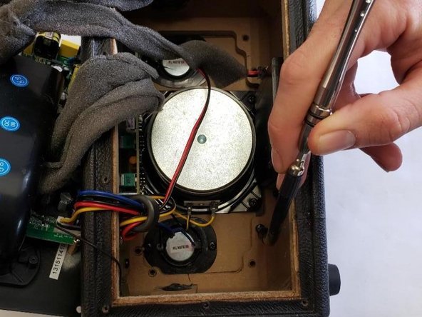

  9. Marshall Kilburn Main Speaker Replacement, Main Speaker: crwdns2935265:09crwdnd2935265:01crwdnd2935265:03crwdne2935265:0 Marshall Kilburn Main Speaker Replacement, Main Speaker: crwdns2935265:09crwdnd2935265:02crwdnd2935265:03crwdne2935265:0 Marshall Kilburn Main Speaker Replacement, Main Speaker: crwdns2935265:09crwdnd2935265:03crwdnd2935265:03crwdne2935265:0
    • Unscrew the eight 22.5mm screws of the speaker cover and the device using a Phillips #2 screwdriver.
    • Gently push the speaker cover out of the stereo speaker.
    • Make sure to slowly push out the speaker cover, and not too far because it is still connected to the stereo speaker.
  10. Marshall Kilburn Main Speaker Replacement: crwdns2935265:010crwdnd2935265:01crwdnd2935265:03crwdne2935265:0 Marshall Kilburn Main Speaker Replacement: crwdns2935265:010crwdnd2935265:02crwdnd2935265:03crwdne2935265:0 Marshall Kilburn Main Speaker Replacement: crwdns2935265:010crwdnd2935265:03crwdnd2935265:03crwdne2935265:0

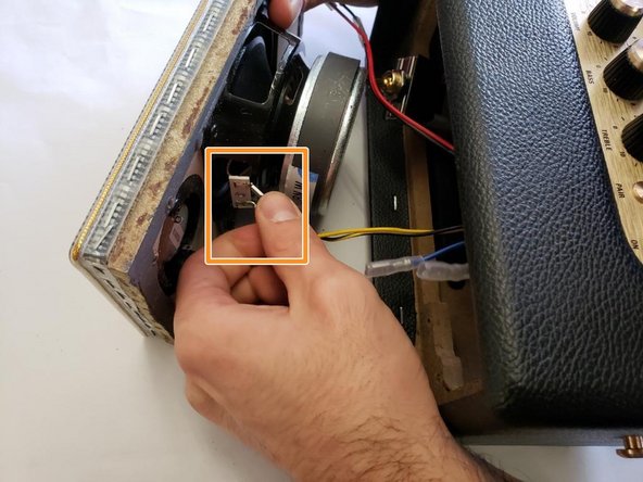

    • Disconnect the blue wires connected to the tweeter.
    • Disconnect the yellow wires connected to the main speaker.
    • Disconnect the red wires connected to the second tweeter.
  11. Marshall Kilburn Main Speaker Replacement: crwdns2935265:011crwdnd2935265:01crwdnd2935265:02crwdne2935265:0 Marshall Kilburn Main Speaker Replacement: crwdns2935265:011crwdnd2935265:02crwdnd2935265:02crwdne2935265:0

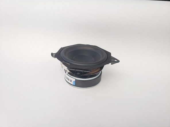

    • Unscrew the four 13.5mm screws connecting the main speaker to the speaker cover, with a Phillips #2 screwdriver.

Google search doesn’t give many results for replacement speakers. Where did you get your replacement speaker? Thanks.
texasbluezman - crwdns2934203:0crwdne2934203:0
Yes, this is an old post, thread. The speaker has mono midrange, bass and stereo treble. The speaker in the center is also a midrange. If you replace it with another type of speaker of the same size, you will change the sound. The sound can quickly become worse.
Fordium -
I am looking for the replacement Speaker as well
Sean G - crwdns2934203:0crwdne2934203:0
The device page has a couple of references that could help you find purchasing information on The Marshall Kilburn.
Jeff Feuss - crwdns2934203:0crwdne2934203:0
I’m also looking for the replacement speaker. Jeff Feuss, you mentioned the “device page,” but I’m not sure where this is (I just joined this site). I get the point of “ifixit,” but I’m ready to call in some help on the repair at this point. I’m going on a year of trying to get my speaker back in working condition. I’ve tried the third party location where I purchased it, BestBuy (wouldn’t service it), and a local electronics repair company. Marshall has been absolutely no help; they only service the Kilburn (1st gen) at the center in England. However, they require the originating address to be in England (won’t return the speaker outside of England). I’m currently seeking friends that live in England. :-)
