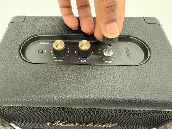

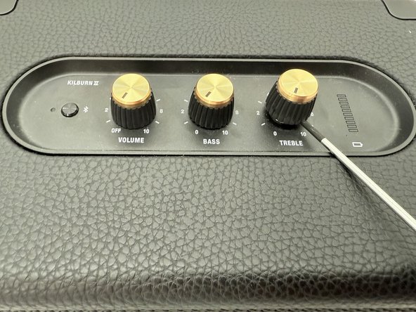

    • Position your speaker so you're looking at the top of the speaker with the three knobs.
    • Using a iFixit opening tool, gently pry up from under the knob to loosen and remove it.
    • Do this for all three knobs.
