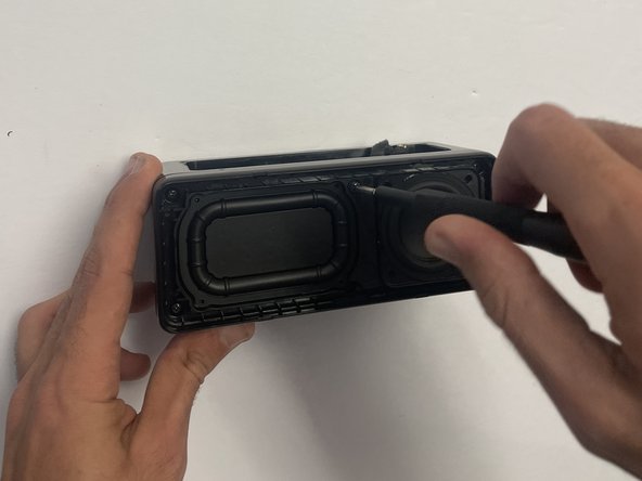

  3. Marshall Emberton Charging Port Bay Replacement: crwdns2935265:03crwdnd2935265:01crwdnd2935265:01crwdne2935265:0
    • Prying the front of the speaker where it says "Marshall" in order to get into the insides of the speaker.

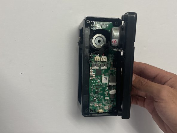

  4. Marshall Emberton Charging Port Bay Replacement: crwdns2935265:04crwdnd2935265:01crwdnd2935265:03crwdne2935265:0 Marshall Emberton Charging Port Bay Replacement: crwdns2935265:04crwdnd2935265:02crwdnd2935265:03crwdne2935265:0 Marshall Emberton Charging Port Bay Replacement: crwdns2935265:04crwdnd2935265:03crwdnd2935265:03crwdne2935265:0
    • Once the "Marshall" part of the speaker is off this is how it will look. It's another protective layer that needs to be removed.
    • When removing all of the eight 1cm screws that are on the protective layer, will give us access to the insides of the speaker.

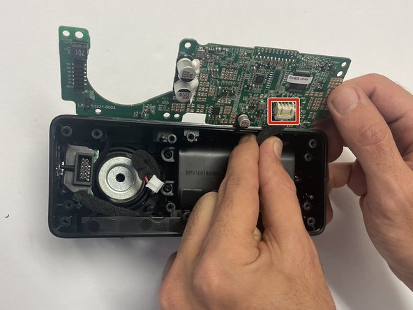

  5. Marshall Emberton Charging Port Bay Replacement: crwdns2935265:05crwdnd2935265:01crwdnd2935265:01crwdne2935265:0
    • Once speaker is opened the motherboard will be the first thing that is seen. Then you will have to look for the 6 1cm screws (Shown in photograph)
  6. Marshall Emberton Charging Port Bay Replacement: crwdns2935265:06crwdnd2935265:01crwdnd2935265:02crwdne2935265:0 Marshall Emberton Charging Port Bay Replacement: crwdns2935265:06crwdnd2935265:02crwdnd2935265:02crwdne2935265:0
    • Once screws are all off, there will be a wire (red/black) that will need to be disconnected from the motherboard.
    • Once the first wire is disconnected from the motherboard, you will then have to flip it over and do the same on the bottom side of the motherboard.
    • Once those wires are disconnected from the motherboard it will simply come right out.
