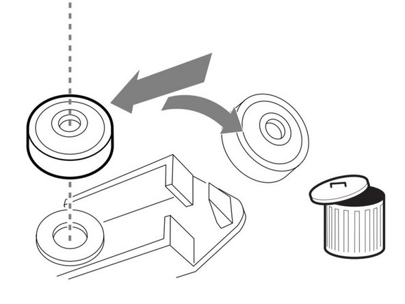

    • Disconnect the O2 cell connector.
    • Lift and discard the O2 cell with the rubber seal to special waste and/or remove and discard the bacterial filter to hazardous waste.
  4. Maquet Servo-U O2 Supply Replacement: crwdns2935265:04crwdnd2935265:01crwdnd2935265:01crwdne2935265:0
    • Ensure that the new rubber seal is intact, then firmly put in a new bacterial filter.
