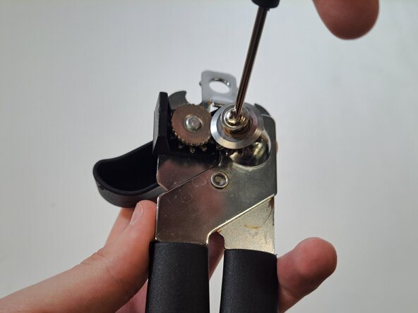

    • Remove the 6 mm Phillips screw that secures the cutting wheel.

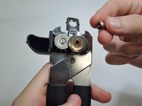

    • Detach the cutting wheel and gear. Place them aside.

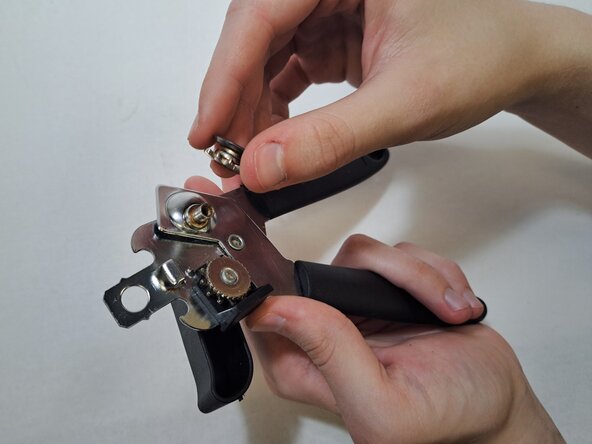

    • Liberally spray the WD-40 onto the rusty areas of the shaft.
    • WD-40 is an extremely flammable aerosol. Avoid spraying it near flames, heat, or hot surfaces.
  4. Manual Top-Cut Can Opener Cutting Wheel Replacement: crwdns2935265:04crwdnd2935265:01crwdnd2935265:02crwdne2935265:0 Manual Top-Cut Can Opener Cutting Wheel Replacement: crwdns2935265:04crwdnd2935265:02crwdnd2935265:02crwdne2935265:0

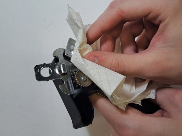

    • Scrub the WD-40 and any rust off the can opener using a scouring pad.
    • Wipe away any excess WD-40 with a paper towel.

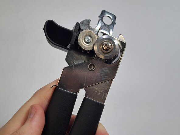

    • Reassemble the can opener by reversing steps 1 and 2 with a new wheel:
    • Place the gear and new cutting wheel onto the shaft.

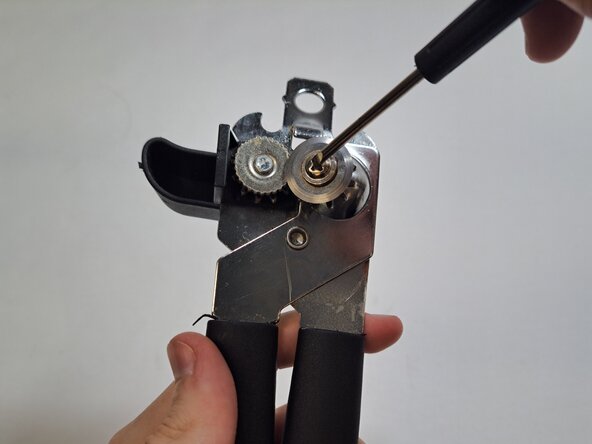

    • Reinsert the 6 mm Phillips screw and fasten it in place.
Once reassembly is complete, your can opener will be as good as new!
