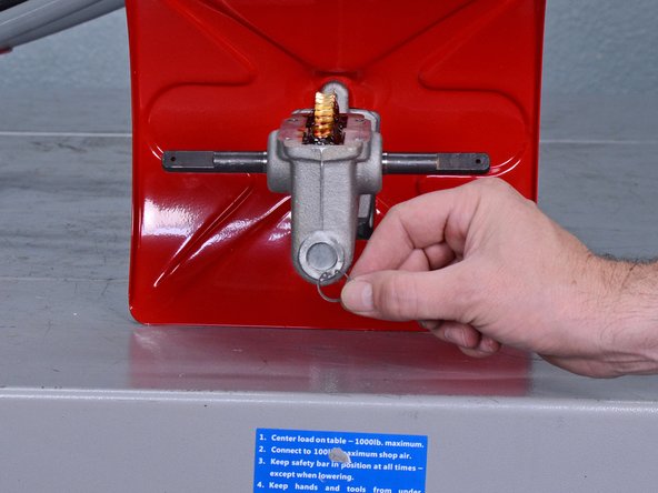

  18. Mantis Tiller 7940 (2017) Worm Shaft Replacement, Remove the retaining ring: crwdns2935265:018crwdnd2935265:01crwdnd2935265:02crwdne2935265:0 Mantis Tiller 7940 (2017) Worm Shaft Replacement, Remove the retaining ring: crwdns2935265:018crwdnd2935265:02crwdnd2935265:02crwdne2935265:0
    • Though the worm gear and tine shaft are shown to be installed in these photos, they should already be removed from your tiller by this point in the procedure.
    • Use a pair of snap ring pliers to remove the retaining ring from the bottom of the worm housing.
    • During reassembly, ensure the worm shaft is sufficiently tapped up into the worm housing before reinstalling the worm disk and retaining ring so that the ring properly sits into its recess.

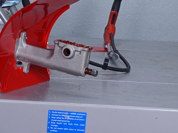

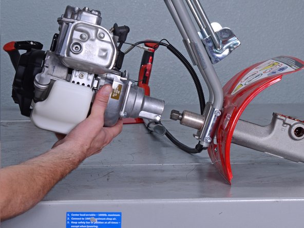

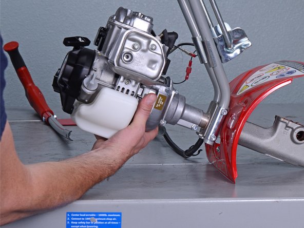

  20. Mantis Tiller 7940 (2017) Worm Shaft Replacement, Remove the engine: crwdns2935265:020crwdnd2935265:01crwdnd2935265:01crwdne2935265:0
    • Use a socket wrench with an 8 mm socket to loosen the 3/4 inch-long flange bolt from the engine flange. It is not necessary to completely remove the flange bolt.
  21. Mantis Tiller 7940 (2017) Worm Shaft Replacement: crwdns2935265:021crwdnd2935265:01crwdnd2935265:03crwdne2935265:0 Mantis Tiller 7940 (2017) Worm Shaft Replacement: crwdns2935265:021crwdnd2935265:02crwdnd2935265:03crwdne2935265:0 Mantis Tiller 7940 (2017) Worm Shaft Replacement: crwdns2935265:021crwdnd2935265:03crwdnd2935265:03crwdne2935265:0
    • Remove the engine from the worm gear housing.

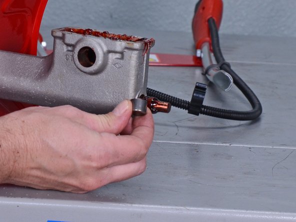

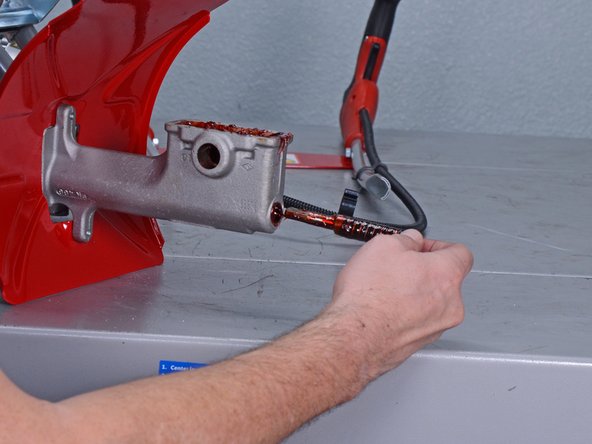

  22. Mantis Tiller 7940 (2017) Worm Shaft Replacement, Remove the drive shaft: crwdns2935265:022crwdnd2935265:01crwdnd2935265:03crwdne2935265:0 Mantis Tiller 7940 (2017) Worm Shaft Replacement, Remove the drive shaft: crwdns2935265:022crwdnd2935265:02crwdnd2935265:03crwdne2935265:0 Mantis Tiller 7940 (2017) Worm Shaft Replacement, Remove the drive shaft: crwdns2935265:022crwdnd2935265:03crwdnd2935265:03crwdne2935265:0
    • Remove the driveshaft from the worm gear housing.

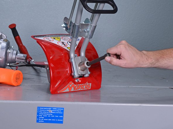

    • Insert a properly sized bushing driver into the top of the worm gear housing.
    • If your bushing driver is too short to reach the worm shaft or too large to fit into the housing, You can use a socket extension or large punch instead/in addition the the bushing driver.

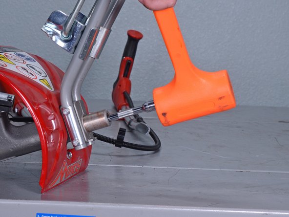

  24. Mantis Tiller 7940 (2017) Worm Shaft Replacement, Tap out the worm shaft assembly: crwdns2935265:024crwdnd2935265:01crwdnd2935265:03crwdne2935265:0 Mantis Tiller 7940 (2017) Worm Shaft Replacement, Tap out the worm shaft assembly: crwdns2935265:024crwdnd2935265:02crwdnd2935265:03crwdne2935265:0 Mantis Tiller 7940 (2017) Worm Shaft Replacement, Tap out the worm shaft assembly: crwdns2935265:024crwdnd2935265:03crwdnd2935265:03crwdne2935265:0
    • Use a dead blow hammer to gradually tap the worm shaft assembly out the bottom of the worm gear housing.
    • If the shaft won't budge with the dead blow hammer, you can try using a ball-peen hammer instead.

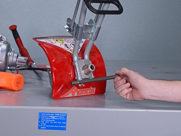

  25. Mantis Tiller 7940 (2017) Worm Shaft Replacement, Remove the lower roller bearing.: crwdns2935265:025crwdnd2935265:01crwdnd2935265:02crwdne2935265:0 Mantis Tiller 7940 (2017) Worm Shaft Replacement, Remove the lower roller bearing.: crwdns2935265:025crwdnd2935265:02crwdnd2935265:02crwdne2935265:0
    • Remove the lower worm shaft roller bearing from the worm shaft.
    • During reassembly, install the lower roller bearing onto the worm shaft before using a bushing driver and dead blow hammer to tap the worm shaft assembly, from the bottom, up back into place.
  26. Mantis Tiller 7940 (2017) Worm Shaft Replacement, Remove the worm shaft: crwdns2935265:026crwdnd2935265:01crwdnd2935265:02crwdne2935265:0 Mantis Tiller 7940 (2017) Worm Shaft Replacement, Remove the worm shaft: crwdns2935265:026crwdnd2935265:02crwdnd2935265:02crwdne2935265:0
    • Remove the worm shaft from out the bottom of the worm gear housing.
