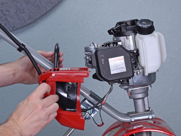

  2. Mantis Tiller 7940 (2017) Tine Shaft Roller Bearings Replacement, Remove the spark plug housing: crwdns2935265:02crwdnd2935265:01crwdnd2935265:01crwdne2935265:0
    • Use a 4 mm hex wrench to remove the bolt securing the spark plug housing.
  3. Mantis Tiller 7940 (2017) Tine Shaft Roller Bearings Replacement: crwdns2935265:03crwdnd2935265:01crwdnd2935265:03crwdne2935265:0 Mantis Tiller 7940 (2017) Tine Shaft Roller Bearings Replacement: crwdns2935265:03crwdnd2935265:02crwdnd2935265:03crwdne2935265:0 Mantis Tiller 7940 (2017) Tine Shaft Roller Bearings Replacement: crwdns2935265:03crwdnd2935265:03crwdnd2935265:03crwdne2935265:0
    • Remove the spark plug housing from the engine.

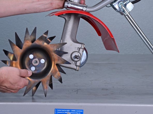

  7. Mantis Tiller 7940 (2017) Tine Shaft Roller Bearings Replacement, Remove the tine assemblies: crwdns2935265:07crwdnd2935265:01crwdnd2935265:02crwdne2935265:0 Mantis Tiller 7940 (2017) Tine Shaft Roller Bearings Replacement, Remove the tine assemblies: crwdns2935265:07crwdnd2935265:02crwdnd2935265:02crwdne2935265:0
    • Slide off and remove the tine retaining pin from the outer face of each tine assembly.
    • Caution: Take care when handling the sharp tines to prevent injuring yourself. Wear work gloves if necessary.
    • The tine assemblies can slide freely once their respective retention pins are removed. Do not let the assemblies fall off the tine shaft as this may damage them or result in injury.
  8. Mantis Tiller 7940 (2017) Tine Shaft Roller Bearings Replacement: crwdns2935265:08crwdnd2935265:01crwdnd2935265:02crwdne2935265:0 Mantis Tiller 7940 (2017) Tine Shaft Roller Bearings Replacement: crwdns2935265:08crwdnd2935265:02crwdnd2935265:02crwdne2935265:0
    • Slide off and remove both tine assemblies from the tine shaft.

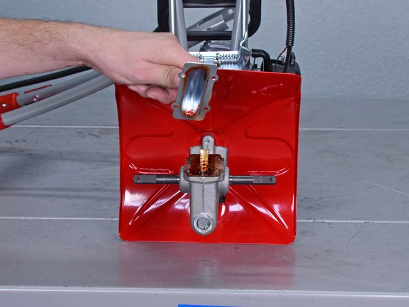

  9. Mantis Tiller 7940 (2017) Tine Shaft Roller Bearings Replacement, Remove the gear housing cover: crwdns2935265:09crwdnd2935265:01crwdnd2935265:01crwdne2935265:0
    • Use a Phillips #2 screwdriver to remove the four screws securing the gear housing cover.
  10. Mantis Tiller 7940 (2017) Tine Shaft Roller Bearings Replacement: crwdns2935265:010crwdnd2935265:01crwdnd2935265:03crwdne2935265:0 Mantis Tiller 7940 (2017) Tine Shaft Roller Bearings Replacement: crwdns2935265:010crwdnd2935265:02crwdnd2935265:03crwdne2935265:0 Mantis Tiller 7940 (2017) Tine Shaft Roller Bearings Replacement: crwdns2935265:010crwdnd2935265:03crwdnd2935265:03crwdne2935265:0
    • Remove the gear housing cover.

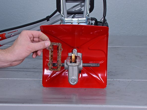

  11. Mantis Tiller 7940 (2017) Tine Shaft Roller Bearings Replacement, Remove the worm housing gasket: crwdns2935265:011crwdnd2935265:01crwdnd2935265:02crwdne2935265:0 Mantis Tiller 7940 (2017) Tine Shaft Roller Bearings Replacement, Remove the worm housing gasket: crwdns2935265:011crwdnd2935265:02crwdnd2935265:02crwdne2935265:0
    • Remove the gear housing cover gasket.
    • We suggest you replace this gasket during reassembly every time you open the worm gear housing to prevent any grease from leaking from the worm drive.
    • During reassembly, refill the worm gear housing with an adequate amount of lithium grease before installing the gasket and housing cover to ensure smooth operation of the worm drive.

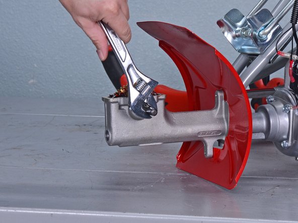

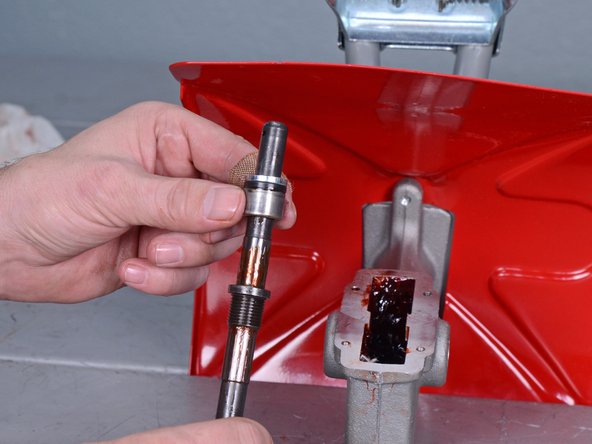

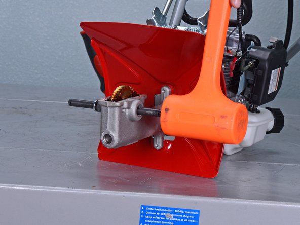

  12. Mantis Tiller 7940 (2017) Tine Shaft Roller Bearings Replacement, Remove the tine shaft: crwdns2935265:012crwdnd2935265:01crwdnd2935265:02crwdne2935265:0 Mantis Tiller 7940 (2017) Tine Shaft Roller Bearings Replacement, Remove the tine shaft: crwdns2935265:012crwdnd2935265:02crwdnd2935265:02crwdne2935265:0
    • Use an adjustable wrench to turn the right half (in the orientation pictured) of the tine shaft clockwise, as shown.
    • Continue to turn the shaft clockwise until it is unthreaded from the worm gear inside the housing.

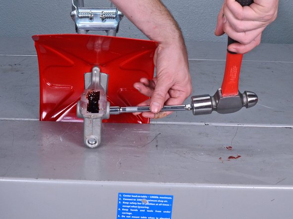

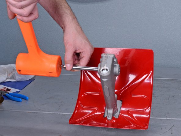

  13. Mantis Tiller 7940 (2017) Tine Shaft Roller Bearings Replacement: crwdns2935265:013crwdnd2935265:01crwdnd2935265:02crwdne2935265:0 Mantis Tiller 7940 (2017) Tine Shaft Roller Bearings Replacement: crwdns2935265:013crwdnd2935265:02crwdnd2935265:02crwdne2935265:0
    • Use a dead blow hammer to tap the right half of the tine shaft towards the worm housing until it can be removed.
    • If the shaft won't budge with the dead blow hammer, you can try using a ball-peen hammer instead.
  14. Mantis Tiller 7940 (2017) Tine Shaft Roller Bearings Replacement: crwdns2935265:014crwdnd2935265:01crwdnd2935265:01crwdne2935265:0
    • Slide the tine shaft assembly out from the left side of the worm housing and remove it.

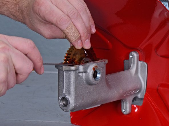

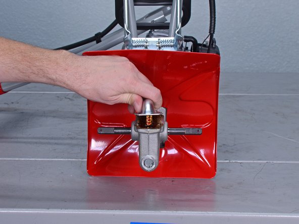

  15. Mantis Tiller 7940 (2017) Tine Shaft Roller Bearings Replacement, Remove the worm gear: crwdns2935265:015crwdnd2935265:01crwdnd2935265:03crwdne2935265:0 Mantis Tiller 7940 (2017) Tine Shaft Roller Bearings Replacement, Remove the worm gear: crwdns2935265:015crwdnd2935265:02crwdnd2935265:03crwdne2935265:0 Mantis Tiller 7940 (2017) Tine Shaft Roller Bearings Replacement, Remove the worm gear: crwdns2935265:015crwdnd2935265:03crwdnd2935265:03crwdne2935265:0

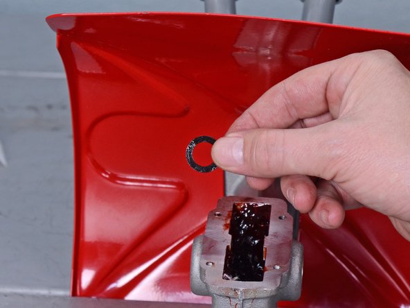

    • Slide the worm gear up out of the worm gear housing about 1 cm.
    • Use a flat head screwdriver to separate the right worm gear thrust washer from the worm gear.

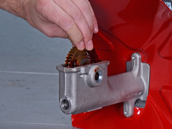

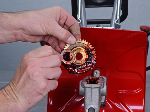

  16. Mantis Tiller 7940 (2017) Tine Shaft Roller Bearings Replacement: crwdns2935265:016crwdnd2935265:01crwdnd2935265:02crwdne2935265:0 Mantis Tiller 7940 (2017) Tine Shaft Roller Bearings Replacement: crwdns2935265:016crwdnd2935265:02crwdnd2935265:02crwdne2935265:0
    • Remove the worm gear and left worm gear thrust washer from the worm housing.
    • Separate the left thrust washer from the worm gear.
    • During reassembly, insert the worm gear into the housing before inserting the thrust washers next to it on either side. All three will be aligned properly once the tine shaft is reinserted.

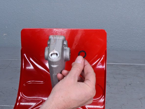

  17. Mantis Tiller 7940 (2017) Tine Shaft Roller Bearings Replacement: crwdns2935265:017crwdnd2935265:01crwdnd2935265:01crwdne2935265:0
    • Remove the right worm gear thrust washer from the worm gear housing.

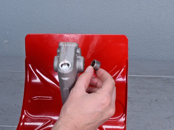

  21. Mantis Tiller 7940 (2017) Tine Shaft Roller Bearings Replacement, Remove the right-hand tine shaft roller bearing: crwdns2935265:021crwdnd2935265:01crwdnd2935265:03crwdne2935265:0 Mantis Tiller 7940 (2017) Tine Shaft Roller Bearings Replacement, Remove the right-hand tine shaft roller bearing: crwdns2935265:021crwdnd2935265:02crwdnd2935265:03crwdne2935265:0 Mantis Tiller 7940 (2017) Tine Shaft Roller Bearings Replacement, Remove the right-hand tine shaft roller bearing: crwdns2935265:021crwdnd2935265:03crwdnd2935265:03crwdne2935265:0
    • Remove the right-hand tine shaft roller bearing assembly.
    • Separate the tine shaft roller bearing from the assembly and remove it.
    • It is recommended that you also replace the bearing seal next to the roller bearing to prevent any grease from leaking out of the worm gear housing.
