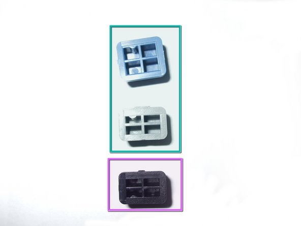

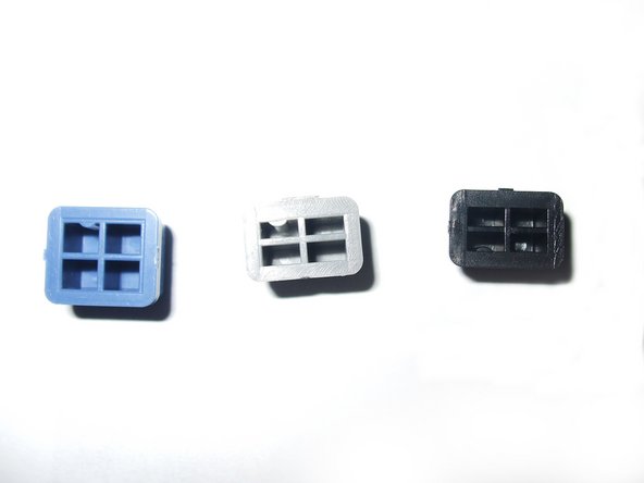

  13. Managing Texas Instruments TI-92 Keyboard: crwdns2935265:013crwdnd2935265:01crwdnd2935265:03crwdne2935265:0 Managing Texas Instruments TI-92 Keyboard: crwdns2935265:013crwdnd2935265:02crwdnd2935265:03crwdne2935265:0 Managing Texas Instruments TI-92 Keyboard: crwdns2935265:013crwdnd2935265:03crwdnd2935265:03crwdne2935265:0
    • When placing the keys back into the faceplate you have to make sure that they are going in the right direction.
    • You can tell which way is up by a semicircular extrusion on the back of a key.
    • The gray and blue keys have the extrusion on the upper left hole looking at the back of the key.
    • The black keys on the other hand have the extrusions on the lower left hole looking at the back of the key.

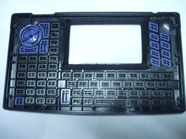

  14. Managing Texas Instruments TI-92 Keyboard: crwdns2935265:014crwdnd2935265:01crwdnd2935265:03crwdne2935265:0 Managing Texas Instruments TI-92 Keyboard: crwdns2935265:014crwdnd2935265:02crwdnd2935265:03crwdne2935265:0 Managing Texas Instruments TI-92 Keyboard: crwdns2935265:014crwdnd2935265:03crwdnd2935265:03crwdne2935265:0
    • Use the pictures shown here as guides for where the keys should go if the keys fell out or you simply chose to remove them.
