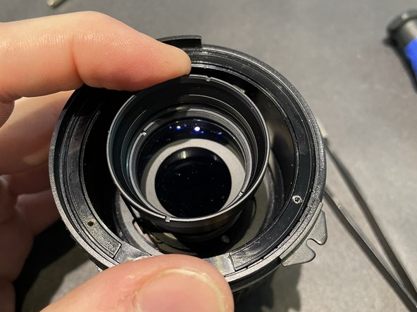

  2. Mamiya 645 150mm f4 lens Disassembly: crwdns2935265:02crwdnd2935265:01crwdnd2935265:01crwdne2935265:0
    • Again using a lens rubber friction tool, remove the front lens group of the lens.
    • The lens group may require significant pressure to get the group to turn. It is tempting to use a lens spanner here, but this is not advised as it may cause the lens group to separate at the wrong point.

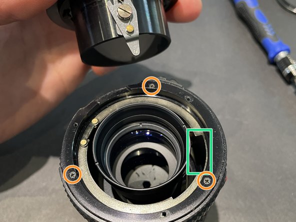

  3. Mamiya 645 150mm f4 lens Disassembly: crwdns2935265:03crwdnd2935265:01crwdnd2935265:02crwdne2935265:0 Mamiya 645 150mm f4 lens Disassembly: crwdns2935265:03crwdnd2935265:02crwdnd2935265:02crwdne2935265:0
    • Flipping the lens around, remove the three marked screws to remove the lens bayonet mount.
    • The housing of the aperture lever can now be removed as well. The lever has to come up through gap shown the metal ring, marked in green.
    • The three screws marked in orange can now be removed. USE CAUTION WHEN HANDLING THE APERTURE RING FROM HERE ON!
    • The aperture ring is now loose, and the small ball bearing the provides the detent is spring loaded and WILL fly off on you if precautions are not taken.

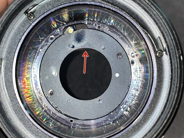

  4. Mamiya 645 150mm f4 lens Disassembly: crwdns2935265:04crwdnd2935265:01crwdnd2935265:02crwdne2935265:0 Mamiya 645 150mm f4 lens Disassembly: crwdns2935265:04crwdnd2935265:02crwdnd2935265:02crwdne2935265:0
    • USE CAUTION WITH THE APERTURE RING DURING THESE STEPS!
    • The thin black ring can now be removed, along with the thin silver ring.
    • The rear lens group can now be unscrewed. This should be possible using your fingers to grip the barrel of the rear element.

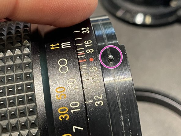

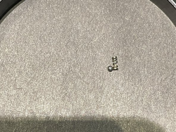

  5. Mamiya 645 150mm f4 lens Disassembly: crwdns2935265:05crwdnd2935265:01crwdnd2935265:03crwdne2935265:0 Mamiya 645 150mm f4 lens Disassembly: crwdns2935265:05crwdnd2935265:02crwdnd2935265:03crwdne2935265:0 Mamiya 645 150mm f4 lens Disassembly: crwdns2935265:05crwdnd2935265:03crwdnd2935265:03crwdne2935265:0
    • Now the aperture ring can be removed. The small, spring loaded ball detent is located near the center marking on the lens, show with a red arrow.
    • To avoid the ball flying to infinity and beyond, cup your hand around the lens near this spot as you remove the aperture ring.
    • Once the ball flies out, be sure to keep an eye out for the spring as well. The spring may still be stuck in the hole circled in purple.

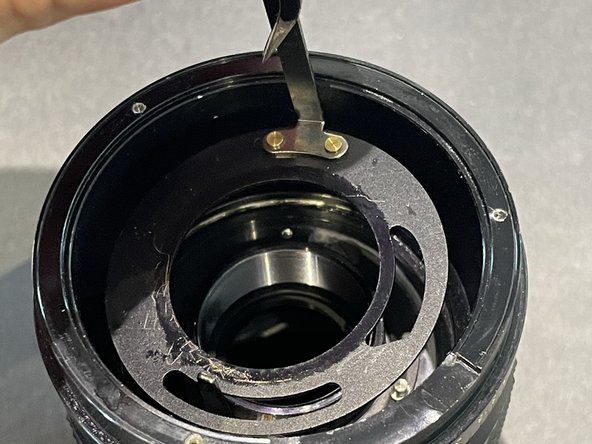

  6. Mamiya 645 150mm f4 lens Disassembly: crwdns2935265:06crwdnd2935265:01crwdnd2935265:02crwdne2935265:0 Mamiya 645 150mm f4 lens Disassembly: crwdns2935265:06crwdnd2935265:02crwdnd2935265:02crwdne2935265:0
    • Remove the silver retaining ring marked in red. This is a spring clip.
    • Place a screw driver under one end of the clip, lifting that end. Using a pair of ben tweezers to get under the lifted end can be helpful.
    • After this, the aperture setting assembly can be lifted out. Easiest way to do so is to lift the silver prong of attached to the disk.
