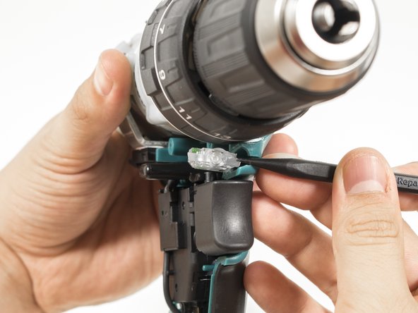

  8. Makita XPH01 LED Light Replacement, LED Light: crwdns2935265:08crwdnd2935265:01crwdnd2935265:02crwdne2935265:0 Makita XPH01 LED Light Replacement, LED Light: crwdns2935265:08crwdnd2935265:02crwdnd2935265:02crwdne2935265:0
    • Use the pointed end of a plastic spudger to push the LED out of the drill.
  9. Makita XPH01 LED Light Replacement: crwdns2935265:09crwdnd2935265:01crwdnd2935265:02crwdne2935265:0 Makita XPH01 LED Light Replacement: crwdns2935265:09crwdnd2935265:02crwdnd2935265:02crwdne2935265:0

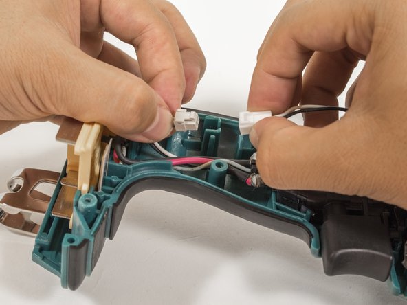

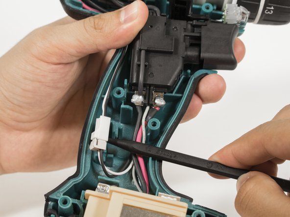

    • Use the pointed edge of a spudger to pull out the black and white wires located on the left hand side of the drill.
    • Use the pointed edge of a spudger to pull out the plastic connector.

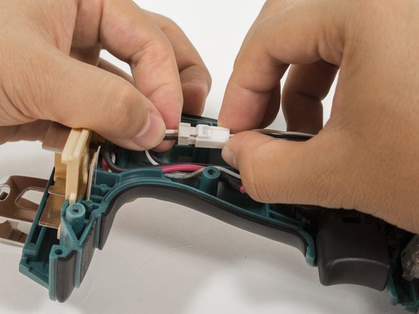

    • Use the flat end of the spudger to push in the clip on the plastic connector.
    • Pull both sides of the plastic connector apart.

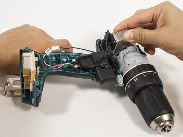

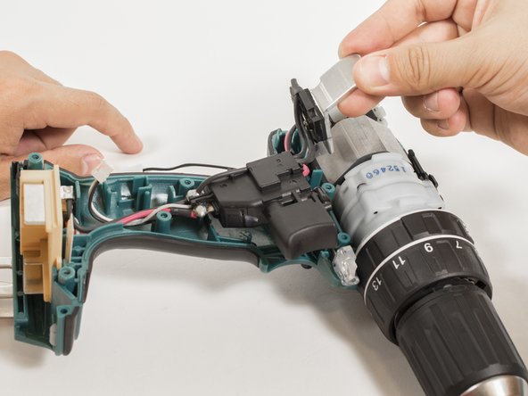

    • Pull the silver metal clip on the motor away from the drill.

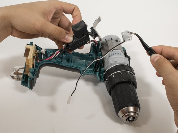

    • Pull the black trigger assembly away from the drill.
  13. Makita XPH01 LED Light Replacement: crwdns2935265:013crwdnd2935265:01crwdnd2935265:02crwdne2935265:0 Makita XPH01 LED Light Replacement: crwdns2935265:013crwdnd2935265:02crwdnd2935265:02crwdne2935265:0
    • Use tweezers to pull out the LED light assembly.
