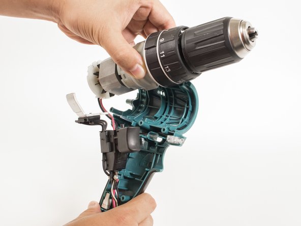

  6. Makita XPH01 Gear Select Switch Replacement: crwdns2935265:06crwdnd2935265:01crwdnd2935265:02crwdne2935265:0 Makita XPH01 Gear Select Switch Replacement: crwdns2935265:06crwdnd2935265:02crwdnd2935265:02crwdne2935265:0
    • Gently grip the front of the motor assembly and pull it out of the plastic casing.
    • The wires are still connected to the back of the motor assembly, so use caution when pulling the motor out. Failing to do this will result in parts falling off the back of the motor

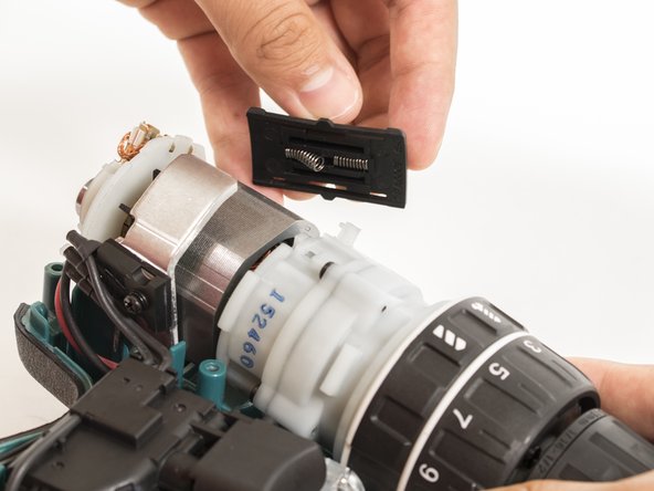

  7. Makita XPH01 Gear Select Switch Replacement: crwdns2935265:07crwdnd2935265:01crwdnd2935265:02crwdne2935265:0 Makita XPH01 Gear Select Switch Replacement: crwdns2935265:07crwdnd2935265:02crwdnd2935265:02crwdne2935265:0
    • Push gear select switch forward.
    • Lift the gear select switch to separate it from the motor assembly.
