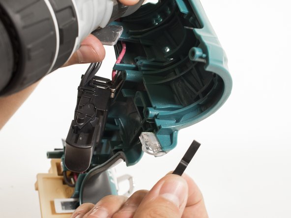

  8. Makita XPH01 Clutch Leaf Spring Replacement, Clutch Leaf Spring: crwdns2935265:08crwdnd2935265:01crwdnd2935265:01crwdne2935265:0
    • Pull the silver metal clip located towards the back of the motor assembly away from the drill.
  9. Makita XPH01 Clutch Leaf Spring Replacement: crwdns2935265:09crwdnd2935265:01crwdnd2935265:02crwdne2935265:0 Makita XPH01 Clutch Leaf Spring Replacement: crwdns2935265:09crwdnd2935265:02crwdnd2935265:02crwdne2935265:0
    • Grip the motor comfortably towards the front of the assembly, and pull it away from the outer casing.
    • The wires are still connected to the back of the motor assembly, so use caution when pulling the motor out. Failing to do this will result in parts falling off the back of the motor.
  10. Makita XPH01 Clutch Leaf Spring Replacement: crwdns2935265:010crwdnd2935265:01crwdnd2935265:02crwdne2935265:0 Makita XPH01 Clutch Leaf Spring Replacement: crwdns2935265:010crwdnd2935265:02crwdnd2935265:02crwdne2935265:0
    • Slide the clutch leaf spring off with the spudger.
