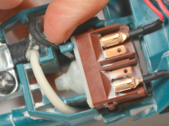

    • Place your finger in the gap in front of the switch.
    • At the base of the device, push the switch lever into the 'on' position.
  4. Makita GA4030K Electrical Cord Replacement: crwdns2935265:04crwdnd2935265:01crwdnd2935265:01crwdne2935265:0
    • Keeping the switch lever in the 'on' position, remove the switch.
    • When reinserting the switch, place the switch in the hole without pressing the switch lever in. Holding the switch against the back edge of the hole, push the switch lever fully into the 'on' position and then let go. The switch should catch onto the switch lever and remain attached.

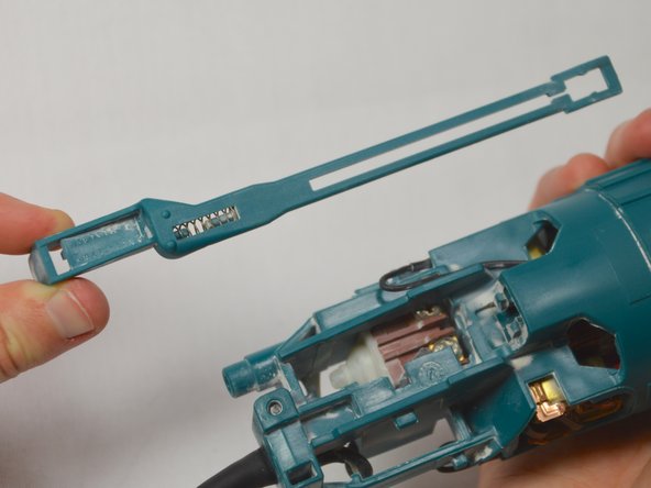

    • Pull the switch lever up and out of the body of the angle grinder.

    • Pull back the plastic clip and pull the internal switch up and out of the cavity.
