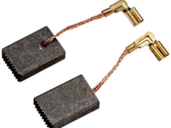

    • First, remove the single black screw from the end of the handle
  2. Makita GA4030K CARBON BRUSH Replacement: crwdns2935265:02crwdnd2935265:01crwdnd2935265:01crwdne2935265:0
    • Separate the handle by pulling the two ends apart.
    • Remove the two screws.
  3. Makita GA4030K CARBON BRUSH Replacement: crwdns2935265:03crwdnd2935265:01crwdnd2935265:01crwdne2935265:0
    • Remove the carbon, and unclip the wires connected to it.
  4. Makita GA4030K CARBON BRUSH Replacement: crwdns2935265:04crwdnd2935265:01crwdnd2935265:02crwdne2935265:0 Makita GA4030K CARBON BRUSH Replacement: crwdns2935265:04crwdnd2935265:02crwdnd2935265:02crwdne2935265:0
    • Old vs. new carbon.
