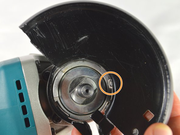

    • Check for the provided lock nut wrench. This is used for loosening the piece that keeps the disk and cover attached.
  2. Makita GA4030K Armature Replacement: crwdns2935265:02crwdnd2935265:01crwdnd2935265:01crwdne2935265:0
    • Unscrew the handle unit until it is removed completely.
  3. Makita GA4030K Armature Replacement: crwdns2935265:03crwdnd2935265:01crwdnd2935265:02crwdne2935265:0 Makita GA4030K Armature Replacement: crwdns2935265:03crwdnd2935265:02crwdnd2935265:02crwdne2935265:0
    • Hold the black switch located on the front casing.
    • Still holding the switch, use the lock nut wrench to loosen the silver disk holding everything in place.
    • Once loose, remove the silver disk and/or your grinding disk.
  4. Makita GA4030K Armature Replacement: crwdns2935265:04crwdnd2935265:01crwdnd2935265:02crwdne2935265:0 Makita GA4030K Armature Replacement: crwdns2935265:04crwdnd2935265:02crwdnd2935265:02crwdne2935265:0
    • Use a Phillips #02 screwdriver to remove the 15 mm pan head screw that holds the cover in place.
    • Remove the cover by lining up the knob on the cover with the notch in face plate.

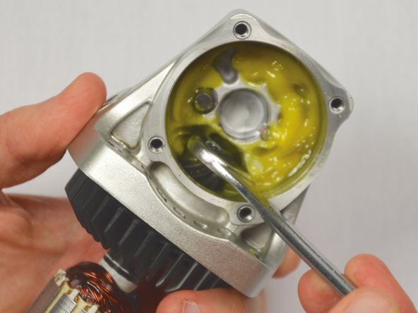

  10. Makita GA4030K Armature Replacement: crwdns2935265:010crwdnd2935265:01crwdnd2935265:02crwdne2935265:0 Makita GA4030K Armature Replacement: crwdns2935265:010crwdnd2935265:02crwdnd2935265:02crwdne2935265:0
    • Unscrew the four 10 mm tapping screws holding the faceplate using a Phillips #02 screwdriver.
    • Remove the faceplate.
  11. Makita GA4030K Armature Replacement: crwdns2935265:011crwdnd2935265:01crwdnd2935265:02crwdne2935265:0 Makita GA4030K Armature Replacement: crwdns2935265:011crwdnd2935265:02crwdnd2935265:02crwdne2935265:0
    • Hold the highlighted nut with a size 10 wrench. Unscrew by turning the armature and holding the nut in place.
    • The nut may be difficult to remove.
  12. Makita GA4030K Armature Replacement: crwdns2935265:012crwdnd2935265:01crwdnd2935265:01crwdne2935265:0
    • Remove the armature.
