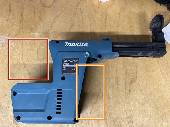

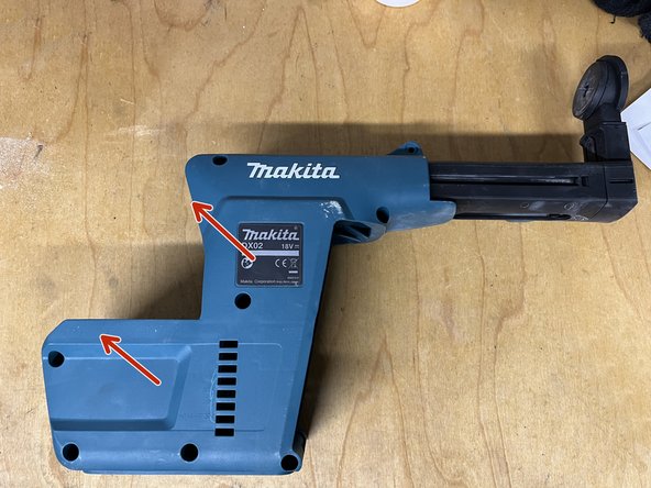

    • Detaching the Unit from the Cordless Drill
    • Remove the Dust Box
    • if necessary, vacuum the dust out of the unit as much as possible at this point (optional)

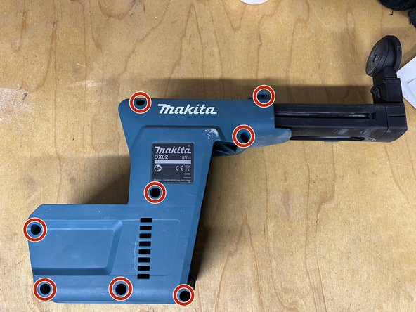

  2. Makita DX02 Dust Extraction Unit for BHR243 Housing Disassembly, Removing the Housing Screws: crwdns2935265:02crwdnd2935265:01crwdnd2935265:01crwdne2935265:0
    • Remove the 8 housing screws with the Phillips screwdriver.

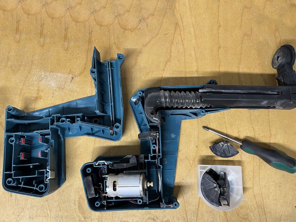

  3. Makita DX02 Dust Extraction Unit for BHR243 Housing Disassembly, Removing the Housing Cover: crwdns2935265:03crwdnd2935265:01crwdnd2935265:02crwdne2935265:0 Makita DX02 Dust Extraction Unit for BHR243 Housing Disassembly, Removing the Housing Cover: crwdns2935265:03crwdnd2935265:02crwdnd2935265:02crwdne2935265:0
    • Remove the Housing Cover
To reassemble your device, follow the steps in reverse order.
