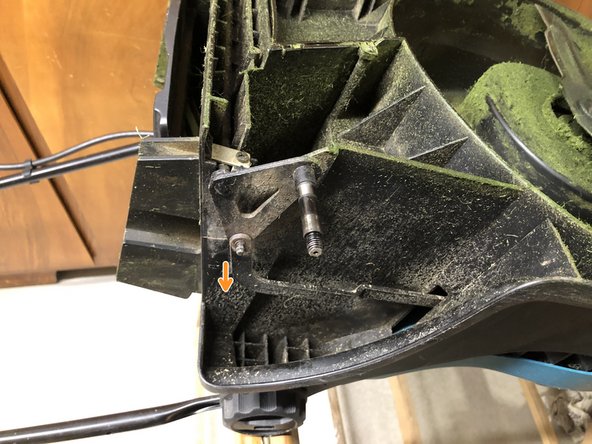

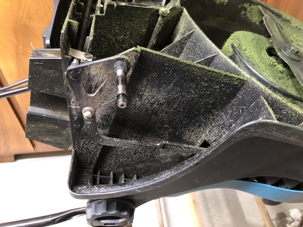

  5. Makita DLM431 Lawn Mower Rear Axle Replacement, Loosening the axle bracket: crwdns2935265:05crwdnd2935265:01crwdnd2935265:03crwdne2935265:0 Makita DLM431 Lawn Mower Rear Axle Replacement, Loosening the axle bracket: crwdns2935265:05crwdnd2935265:02crwdnd2935265:03crwdne2935265:0 Makita DLM431 Lawn Mower Rear Axle Replacement, Loosening the axle bracket: crwdns2935265:05crwdnd2935265:03crwdnd2935265:03crwdne2935265:0
    • Remove screws with a Phillips screwdriver.
    • Push the axle holder backwards through the fairing to expose the axle.
  6. Makita DLM431 Lawn Mower Rear Axle Replacement, Replace rear axle: crwdns2935265:06crwdnd2935265:01crwdnd2935265:01crwdne2935265:0
    • Remove the old axle upwards.
    • Attach new axle.
Congrats! Now follow the steps in reverse order to reassemble your unit.
