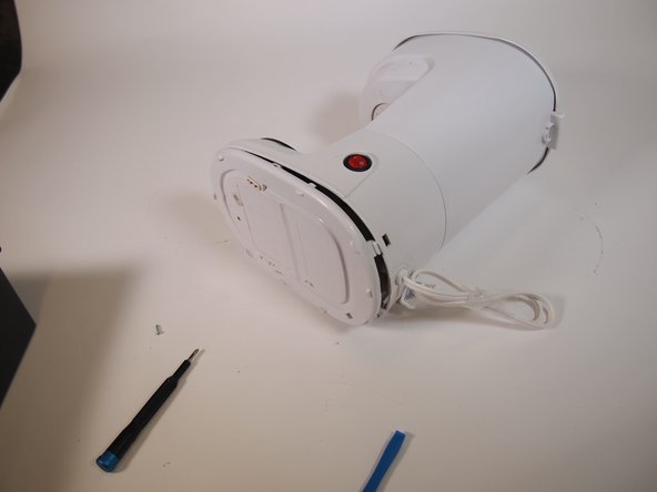

    • Inspect the bottom of the coffee maker and find the small hole near the middle of the lid. There should be a screw inside this hole.
  2. Mainstays White 12 Cup Drip Coffee Maker 28035441 Disassembly: crwdns2935265:02crwdnd2935265:01crwdnd2935265:02crwdne2935265:0 Mainstays White 12 Cup Drip Coffee Maker 28035441 Disassembly: crwdns2935265:02crwdnd2935265:02crwdnd2935265:02crwdne2935265:0
    • Use a Phillips screwdriver remove that screw 13 mm screw on the bottom of the coffeemaker.

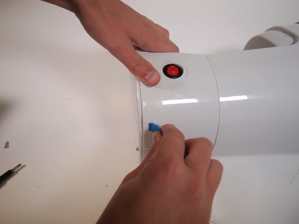

    • Once that screw is off, locate the 2 push latches on the back and bottom side of the coffee maker.
    • Use a pry tool to initially dislodge the previously mentioned latches.
    • Given the age of your coffeemaker, this dislodging process will likely bring you little success. Just try to loosen up the latch for the following step.

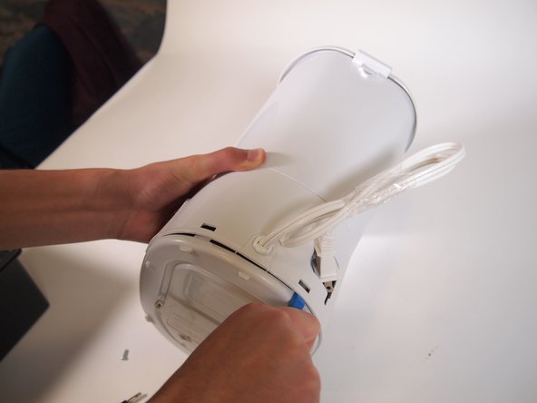

  4. Mainstays White 12 Cup Drip Coffee Maker 28035441 Disassembly: crwdns2935265:04crwdnd2935265:01crwdnd2935265:03crwdne2935265:0 Mainstays White 12 Cup Drip Coffee Maker 28035441 Disassembly: crwdns2935265:04crwdnd2935265:02crwdnd2935265:03crwdne2935265:0 Mainstays White 12 Cup Drip Coffee Maker 28035441 Disassembly: crwdns2935265:04crwdnd2935265:03crwdnd2935265:03crwdne2935265:0
    • Use a prying tool to pry the bottom of the coffee maker off, pushing the sharper end into the crevice and using the tool like a lever to lift the lid off.
