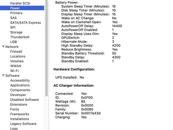

    3. Magsafe 1 powered By USB C Universal Adapter Method: crwdns2935265:03crwdnd2935265:01crwdnd2935265:03crwdne2935265:0 Magsafe 1 powered By USB C Universal Adapter Method: crwdns2935265:03crwdnd2935265:02crwdnd2935265:03crwdne2935265:0 Magsafe 1 powered By USB C Universal Adapter Method: crwdns2935265:03crwdnd2935265:03crwdnd2935265:03crwdne2935265:0
      • Although this is a 65W power supply my MacBook Pro' System Report believes it's an 85W.

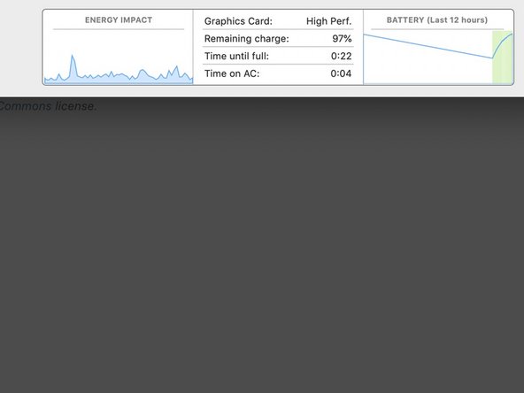

      • In activity monitor the battery charging is plotted. Halfway up the charge slope is a regular MacBook charger. The last half of the upward slope is this USB C mod.
