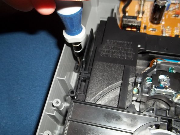

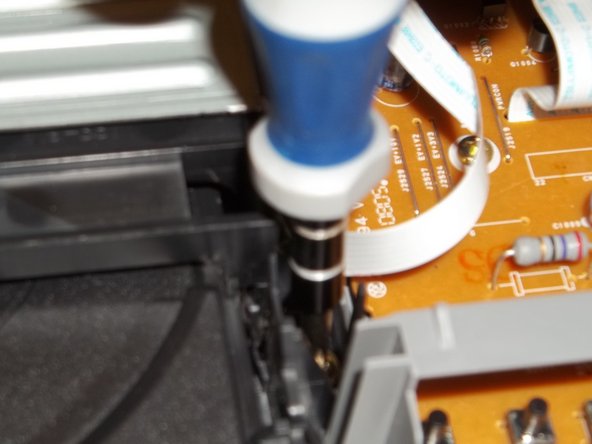

    • Use a Phillips #2 screwdriver to remove the two screws at the base of the disk drive.

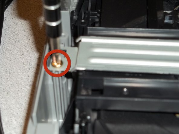

    • Use the screwdriver to remove two screws on either side of the silver security bar.
  7. Magnavox MWD200F Disk Drive Replacement: crwdns2935265:07crwdnd2935265:01crwdnd2935265:02crwdne2935265:0 Magnavox MWD200F Disk Drive Replacement: crwdns2935265:07crwdnd2935265:02crwdnd2935265:02crwdne2935265:0
    • Pull out the silver security bar and set aside.

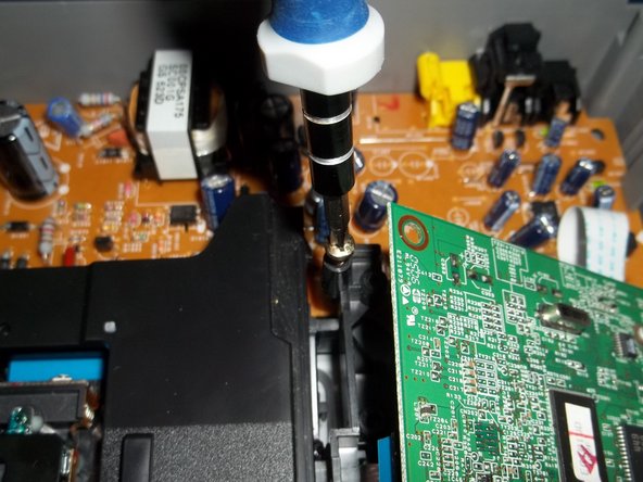

  8. Magnavox MWD200F Disk Drive Replacement: crwdns2935265:08crwdnd2935265:01crwdnd2935265:01crwdne2935265:0

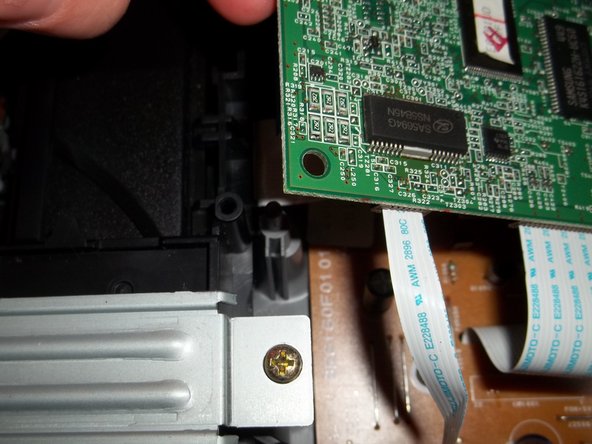

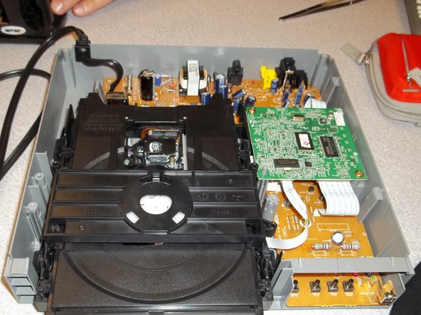

    • Take out the two screws on either side of the green circuit board.
  9. Magnavox MWD200F Disk Drive Replacement: crwdns2935265:09crwdnd2935265:01crwdnd2935265:02crwdne2935265:0 Magnavox MWD200F Disk Drive Replacement: crwdns2935265:09crwdnd2935265:02crwdnd2935265:02crwdne2935265:0
    • Carefully lift the board just enough to remove the disk drive.
  10. Magnavox MWD200F Disk Drive Replacement: crwdns2935265:010crwdnd2935265:01crwdnd2935265:03crwdne2935265:0 Magnavox MWD200F Disk Drive Replacement: crwdns2935265:010crwdnd2935265:02crwdnd2935265:03crwdne2935265:0 Magnavox MWD200F Disk Drive Replacement: crwdns2935265:010crwdnd2935265:03crwdnd2935265:03crwdne2935265:0

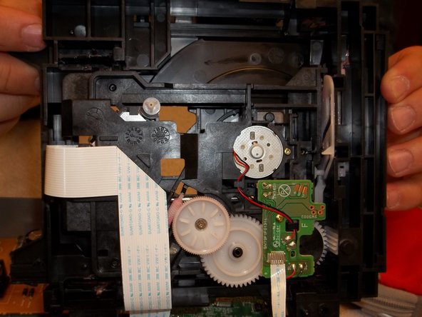

    • Remove the two screws at the back of the disk drive.
  11. Magnavox MWD200F Disk Drive Replacement: crwdns2935265:011crwdnd2935265:01crwdnd2935265:02crwdne2935265:0 Magnavox MWD200F Disk Drive Replacement: crwdns2935265:011crwdnd2935265:02crwdnd2935265:02crwdne2935265:0
    • Gently lift the disk drive out of the DVD player.
    • The disk drive is still attached but you are now able to get to underneath it for cleaning and maintenance.
