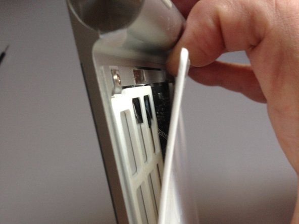

      • Using a spudger or small flathead screwdriver, gently break the seal between the white plastic backing and the metal top near the missing foot opening.
      • Pry up the corner slightly to allow the foot to be replaced.
      • Place the rubber foot back in place.
      • Squeeze closed the backing and metal top (it will snap into place).
      • Click on trackpad to test.
      • Insert the battery and screw the battery cover closed.
      • A foot may again dislodge, for example when you inadvertently move a sheet of paper under the trackpad. Repeat steps as needed to replace.
    4. Magic Trackpad Rubber Replacement/Reinsertion: crwdns2935265:04crwdnd2935265:01crwdnd2935265:03crwdne2935265:0 Magic Trackpad Rubber Replacement/Reinsertion: crwdns2935265:04crwdnd2935265:02crwdnd2935265:03crwdne2935265:0 Magic Trackpad Rubber Replacement/Reinsertion: crwdns2935265:04crwdnd2935265:03crwdnd2935265:03crwdne2935265:0
      • If you want to remove the plastic cover completely, it is better to open it starting from the top.
      • Opening from the top will reduce the risk of breaking any of the clips at the bottom.
      • The cover is attached to the trackpad through rubber glue on the plastic grid and four clips on the bottom.
      • Take your time to slowly open the plastic cover from the top side.
