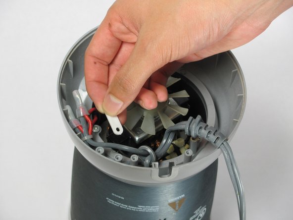

    • Before beginning, make sure the device is unplugged.
    • With a Phillips head #2 screwdriver, begin unscrewing the four 10mm screws located on the bottom of the power base.
  2. Magic Bullet NutriBullet Power Cord Replacement: crwdns2935265:02crwdnd2935265:01crwdnd2935265:01crwdne2935265:0
    • Once the screws are removed, pull the plastic base up gently.
    • Once the plastic base is removed, there is a fan located in the center of the powerbase. Make sure the cord does not get caught or frayed by the fan.
  3. Magic Bullet NutriBullet Power Cord Replacement: crwdns2935265:03crwdnd2935265:01crwdnd2935265:01crwdne2935265:0
    • Gently lift the power cord from its side slot and place it to the side.
  4. Magic Bullet NutriBullet Power Cord Replacement: crwdns2935265:04crwdnd2935265:01crwdnd2935265:02crwdne2935265:0 Magic Bullet NutriBullet Power Cord Replacement: crwdns2935265:04crwdnd2935265:02crwdnd2935265:02crwdne2935265:0
    • With the Phillips head #2 screwdriver, remove the two 10mm screws that secure the white bracket.
    • The white safety bracket holds the cord down. After removing it, the cord will be free.
  5. Magic Bullet NutriBullet Power Cord Replacement: crwdns2935265:05crwdnd2935265:01crwdnd2935265:01crwdne2935265:0
    • After removing the gray base and silver casing, the wires will now be free and you will have easy access to them.
    • Gently pull out the two plastic covers at the end of the wires.
  6. Magic Bullet NutriBullet Power Cord Replacement: crwdns2935265:06crwdnd2935265:01crwdnd2935265:01crwdne2935265:0
    • Use tape or clamps to hold the wires together for an easy soldering experience.
    • Using a soldering iron, solder your new wire to the red wire.
Since this guide replacement requires cutting wires, if you want to reassemble this device, you must first re-solder new wires before following the steps backwards to reassemble the device.
