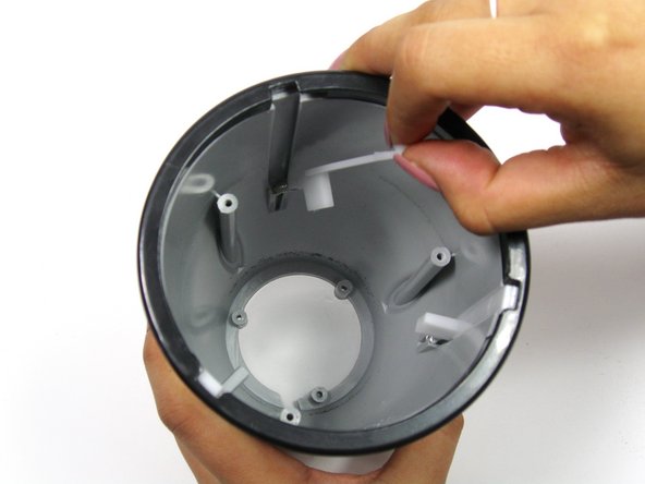

    1. Magic Bullet MB1001B Activator Replacement, Activator: crwdns2935265:012crwdnd2935265:01crwdnd2935265:02crwdne2935265:0 Magic Bullet MB1001B Activator Replacement, Activator: crwdns2935265:012crwdnd2935265:02crwdnd2935265:02crwdne2935265:0
      • Wedge a flathead screwdriver in between the casing and white plastic activator.
      • Pry the white plastic activators from the casing as needed.
