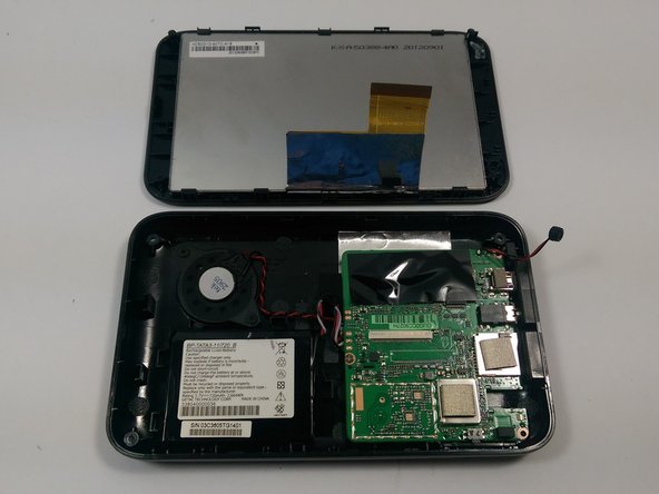

    • Using the plastic opening tool, gently pry apart the front and back casing panels around the edges of the device. While doing this the clips will gently be pried apart allowing you to separate the front and back casings.
    • There is a ribbon cable that will still connect the front panel to the motherboard.
  3. Magellan RoadMate 5265T-LMB Speaker Replacement: crwdns2935265:03crwdnd2935265:01crwdnd2935265:02crwdne2935265:0 Magellan RoadMate 5265T-LMB Speaker Replacement: crwdns2935265:03crwdnd2935265:02crwdnd2935265:02crwdne2935265:0
    • The ribbon cable is attached to the motherboard by a ZIF (Zero Insertion Force) connector.
    • Using the nylon or metal spudger, gently pop up the ZIF connector tab and remove the ribbon cable. This will allow you to separate the front panel from the motherboard.
    • Gently pull the front panel away and set it on your workstation.

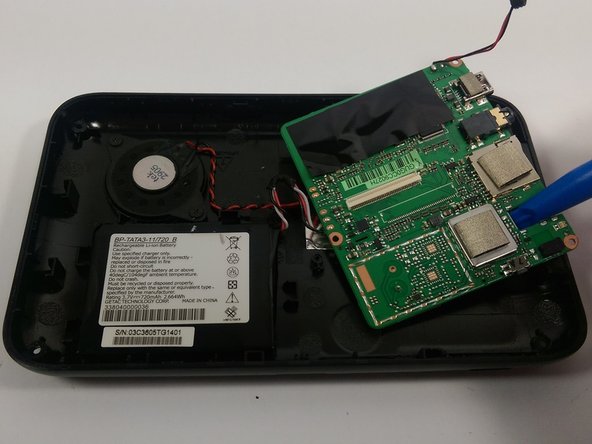

  4. Magellan RoadMate 5265T-LMB Speaker Replacement: crwdns2935265:04crwdnd2935265:01crwdnd2935265:01crwdne2935265:0
    • Make sure the back panel is lying on a flat surface with the open side showing up.
    • Using a plastic opening tool, gently lift the battery to break the adhesive which binds it to the back panel.
  5. Magellan RoadMate 5265T-LMB Speaker Replacement: crwdns2935265:05crwdnd2935265:01crwdnd2935265:02crwdne2935265:0 Magellan RoadMate 5265T-LMB Speaker Replacement: crwdns2935265:05crwdnd2935265:02crwdnd2935265:02crwdne2935265:0

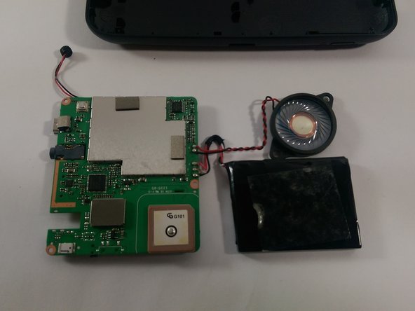

    • Unscrew the three screws holding the motherboard and speakers in place. Use a size 0 phillips head screwdriver.
    • Now you may remove the motherboard, speaker, and battery as one unit from the back panel itself.
    • Flip over these components and gently place them down on your workstation, so that the back of the motherboard is revealed.
  6. Magellan RoadMate 5265T-LMB Speaker Replacement: crwdns2935265:06crwdnd2935265:01crwdnd2935265:03crwdne2935265:0 Magellan RoadMate 5265T-LMB Speaker Replacement: crwdns2935265:06crwdnd2935265:02crwdnd2935265:03crwdne2935265:0 Magellan RoadMate 5265T-LMB Speaker Replacement: crwdns2935265:06crwdnd2935265:03crwdnd2935265:03crwdne2935265:0

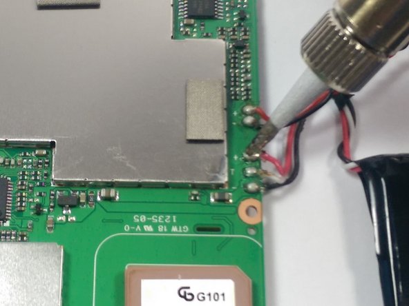

    • While inspecting the back of the motherboard, you will be able to see the two wires connecting it to the speaker. Both of these wires are soldered onto the motherboard itself so a soldering iron will be necessary to remove them.
    • Using a soldering iron, carefully desolder both wires allowing you to separate the speaker from the motherboard.
