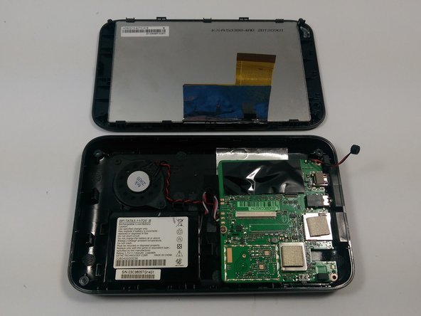

    • Make sure the back panel is lying on a flat surface with the open side showing up.
    • Using a plastic opening tool, gently lift the battery to break the adhesive which binds it to the back panel.
  5. Magellan RoadMate 5265T-LMB Motherboard Replacement: crwdns2935265:05crwdnd2935265:01crwdnd2935265:02crwdne2935265:0 Magellan RoadMate 5265T-LMB Motherboard Replacement: crwdns2935265:05crwdnd2935265:02crwdnd2935265:02crwdne2935265:0

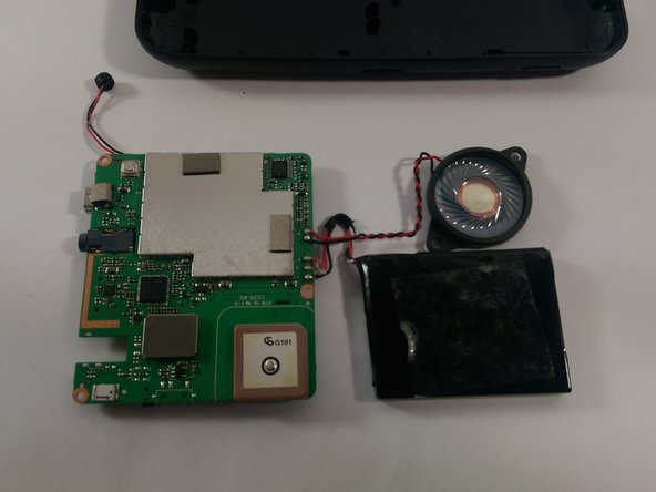

    • Unscrew the three screws holding the motherboard and speakers in place. Use a size 0 phillips head screwdriver.
    • Now you may remove the motherboard, speaker, and battery as one unit from the back panel itself.
    • Flip over these components and gently place them down on your workstation, so that the back of the motherboard is revealed.
  6. Magellan RoadMate 5265T-LMB Motherboard Replacement: crwdns2935265:06crwdnd2935265:01crwdnd2935265:02crwdne2935265:0 Magellan RoadMate 5265T-LMB Motherboard Replacement: crwdns2935265:06crwdnd2935265:02crwdnd2935265:02crwdne2935265:0

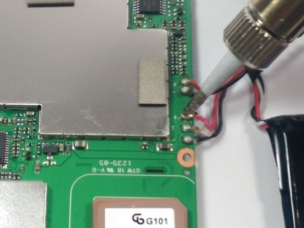

    • While inspecting the back of the motherboard, you will be able to see five wires connecting the battery and the speaker to the motherboard itself. All of these wires are soldered onto the motherboard so a soldering iron will be necessary to remove them.
    • Using a soldering iron, carefully desolder all five wires allowing you to separate the motherboard from the battery and speaker.
