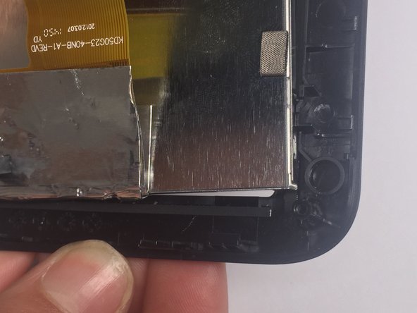

  4. Magellan RoadMate 5250T-LM Screen Replacement: crwdns2935265:04crwdnd2935265:01crwdnd2935265:02crwdne2935265:0 Magellan RoadMate 5250T-LM Screen Replacement: crwdns2935265:04crwdnd2935265:02crwdnd2935265:02crwdne2935265:0
    • Undo the four clamps holding down the display.
    • Remove the display from the front cover.
