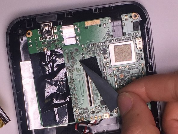

    • Remove the tape covering the display connector on top of the motherboard.
    • Use a nylon spudger to flip up the black tab on the ZIF connector.
    • Pull the ribbon cable out with tweezers.
    • The ribbon cable may fall out once the tape is removed.

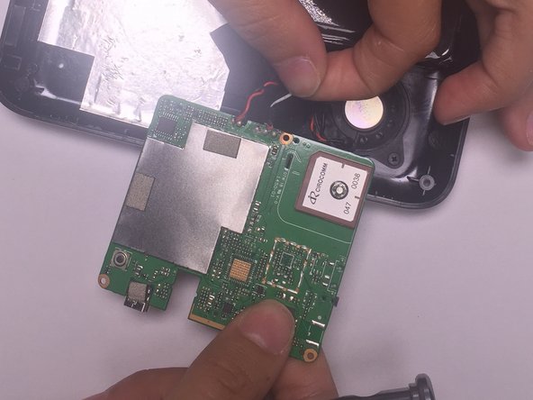

    • Remove the motherboard from the device by unscrewing all three 4mm screws that are connecting it to the casing with a Phillips Head screwdriver size 000.
  5. Magellan RoadMate 5250T-LM Motherboard Replacement: crwdns2935265:05crwdnd2935265:01crwdnd2935265:01crwdne2935265:0
    • Disconnect the original battery from the motherboard and the speaker by desoldering all five wires that attach them to the motherboard.
