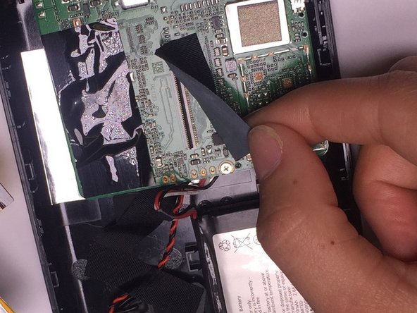

    • Remove the tape covering the display connector on top of the motherboard.
    • Use a nylon spudger to flip up the black tab on the ZIF connector.
    • Pull the ribbon cable out with tweezers.
    • The ribbon cable may fall out once the tape is removed.

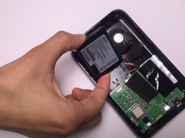

    • Pry off the original battery using a spudger to break the adhesive that connects the battery to the back casing.

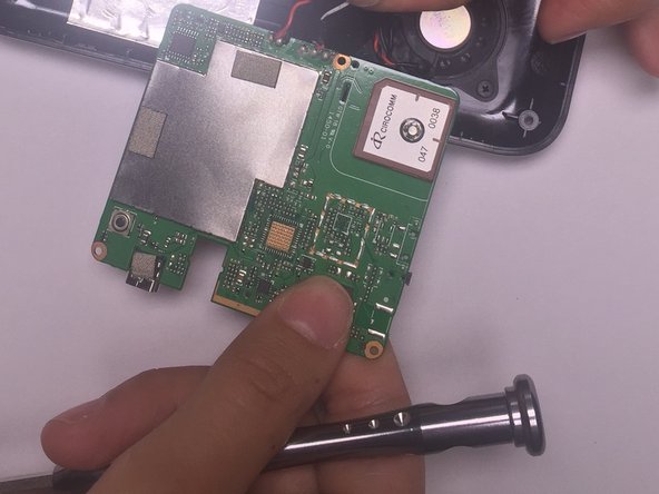

    • Remove the motherboard from the device by unscrewing all three 4 mm screws that are connecting it to the casing with a Phillips Head screwdriver size 000.
  6. Magellan RoadMate 5250T-LM Battery Replacement: crwdns2935265:06crwdnd2935265:01crwdnd2935265:01crwdne2935265:0
    • Disconnect the original battery from the motherboard by desoldering all three wires that attach it to the motherboard.
    • Click here to refer to iFixit's soldering technique guide for this step.
