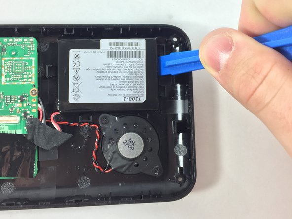

  4. Magellan RoadMate 5236T-LM Speaker Replacement, Speaker: crwdns2935265:04crwdnd2935265:01crwdnd2935265:02crwdne2935265:0 Magellan RoadMate 5236T-LM Speaker Replacement, Speaker: crwdns2935265:04crwdnd2935265:02crwdnd2935265:02crwdne2935265:0
    • Lay the back panel on a flat surface with the battery, motherboard, and speaker facing up.
    • Use a plastic opening tool to gently pull the battery away from the back panel in order to remove the adhesive that helps the battery stick to the panel.
  5. Magellan RoadMate 5236T-LM Speaker Replacement: crwdns2935265:05crwdnd2935265:01crwdnd2935265:01crwdne2935265:0
    • Unscrew the two 5mm screws using a Phillips #000 screwdriver.

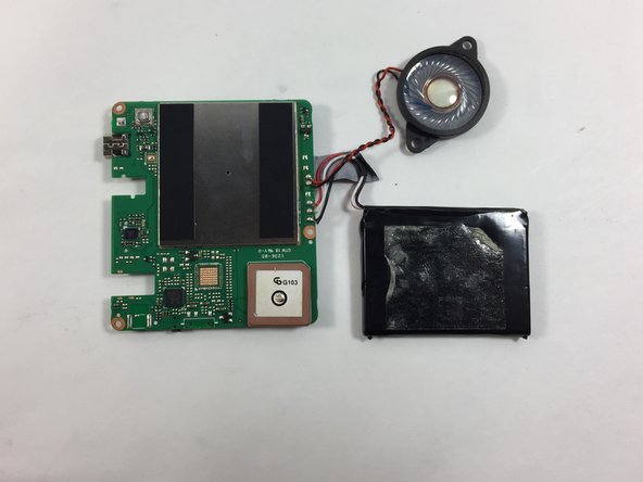

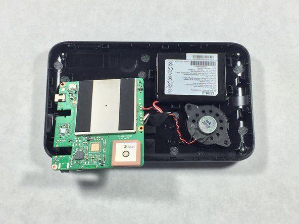

  6. Magellan RoadMate 5236T-LM Speaker Replacement: crwdns2935265:06crwdnd2935265:01crwdnd2935265:03crwdne2935265:0 Magellan RoadMate 5236T-LM Speaker Replacement: crwdns2935265:06crwdnd2935265:02crwdnd2935265:03crwdne2935265:0 Magellan RoadMate 5236T-LM Speaker Replacement: crwdns2935265:06crwdnd2935265:03crwdnd2935265:03crwdne2935265:0
    • Use a Phillips #000 screwdriver to remove three 5mm screws that hold the motherboard down to the the back panel.
    • Remove the battery, speaker and motherboard. Place them on a flat surface upside down.
