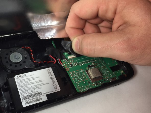

    • A ribbon cable attaches the display screen and the motherboard via a ZIF connector. Remove the tape covering where the ZIF connector connects to the mother board.
    • Use tweezers to disconnect the ZIF connector from the motherboard.
    • The ZIF connector may disconnect itself from the motherboard when removing the tape.
