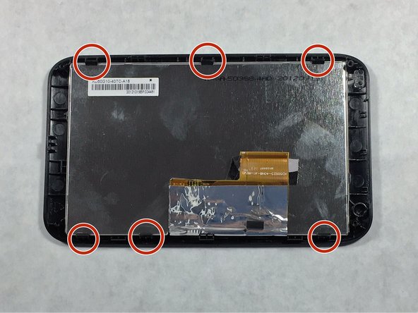

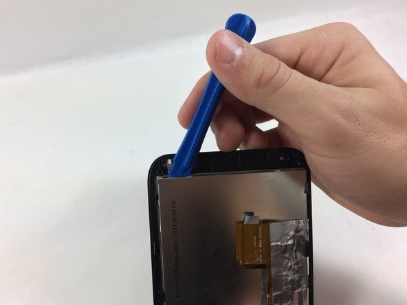

  4. Magellan RoadMate 5236T-LM Display Screen Replacement, Display Screen: crwdns2935265:04crwdnd2935265:01crwdnd2935265:03crwdne2935265:0 Magellan RoadMate 5236T-LM Display Screen Replacement, Display Screen: crwdns2935265:04crwdnd2935265:02crwdnd2935265:03crwdne2935265:0 Magellan RoadMate 5236T-LM Display Screen Replacement, Display Screen: crwdns2935265:04crwdnd2935265:03crwdnd2935265:03crwdne2935265:0
    • Place the front panel on a flat surface, screen side down.
    • Using a plastic opening tool, apply light lifting pressure to each of the 6 casing clips to release the screen from the plastic casing.
