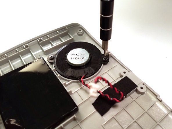

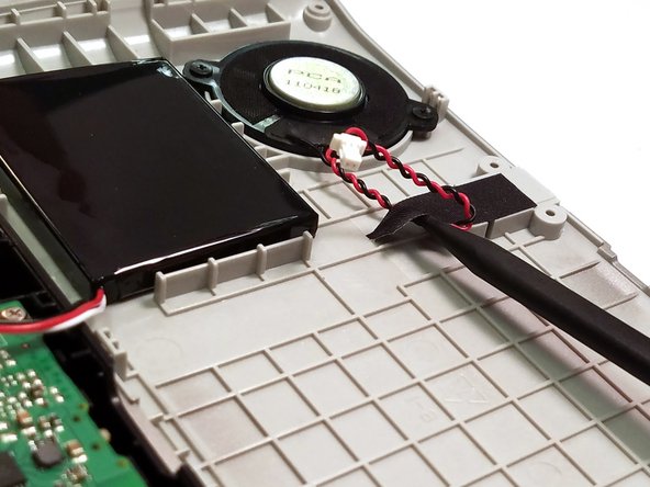

  3. Magellan RoadMate 5120-LMTX Speaker Replacement, Speaker: crwdns2935265:03crwdnd2935265:01crwdnd2935265:02crwdne2935265:0 Magellan RoadMate 5120-LMTX Speaker Replacement, Speaker: crwdns2935265:03crwdnd2935265:02crwdnd2935265:02crwdne2935265:0
    • Open the device and remove the tape from the speaker wire using the spudger.
  4. Magellan RoadMate 5120-LMTX Speaker Replacement: crwdns2935265:04crwdnd2935265:01crwdnd2935265:02crwdne2935265:0 Magellan RoadMate 5120-LMTX Speaker Replacement: crwdns2935265:04crwdnd2935265:02crwdnd2935265:02crwdne2935265:0
    • Remove the two 4mm Phillips #00 screws securing the speaker assembly and remove speaker.
