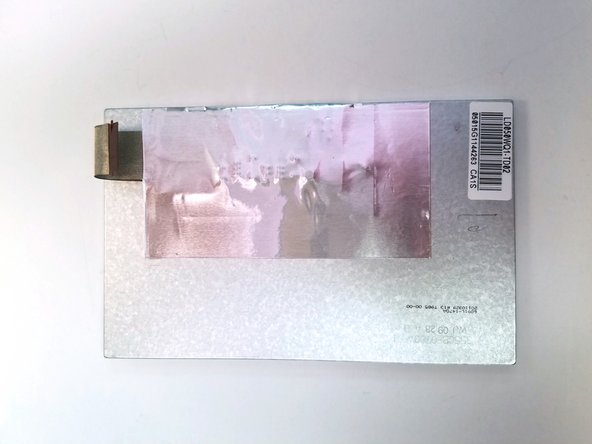

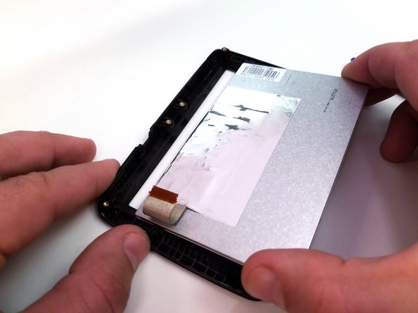

  6. Magellan RoadMate 5120-LMTX Screen Replacement, Screen: crwdns2935265:06crwdnd2935265:01crwdnd2935265:03crwdne2935265:0 Magellan RoadMate 5120-LMTX Screen Replacement, Screen: crwdns2935265:06crwdnd2935265:02crwdnd2935265:03crwdne2935265:0 Magellan RoadMate 5120-LMTX Screen Replacement, Screen: crwdns2935265:06crwdnd2935265:03crwdnd2935265:03crwdne2935265:0
    • Use a plastic opening tool to release the screen from the tabs.
    • Using too much force can break the tabs.
    • Lift and slide the screen out from the housing.
    • If the screen is cracked, be careful of sharp or loose glass shards.
