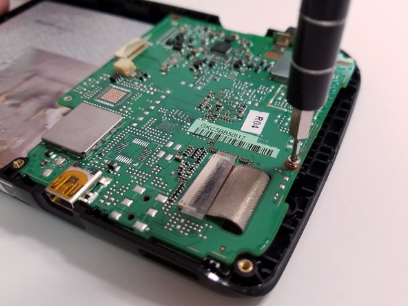

  3. Magellan RoadMate 5120-LMTX Motherboard Replacement, Motherboard: crwdns2935265:03crwdnd2935265:01crwdnd2935265:03crwdne2935265:0 Magellan RoadMate 5120-LMTX Motherboard Replacement, Motherboard: crwdns2935265:03crwdnd2935265:02crwdnd2935265:03crwdne2935265:0 Magellan RoadMate 5120-LMTX Motherboard Replacement, Motherboard: crwdns2935265:03crwdnd2935265:03crwdnd2935265:03crwdne2935265:0

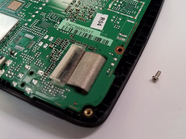

    • There will be two 5mm Phillips #00 screws that need to be removed from the motherboard.
  4. Magellan RoadMate 5120-LMTX Motherboard Replacement: crwdns2935265:04crwdnd2935265:01crwdnd2935265:03crwdne2935265:0 Magellan RoadMate 5120-LMTX Motherboard Replacement: crwdns2935265:04crwdnd2935265:02crwdnd2935265:03crwdne2935265:0 Magellan RoadMate 5120-LMTX Motherboard Replacement: crwdns2935265:04crwdnd2935265:03crwdnd2935265:03crwdne2935265:0

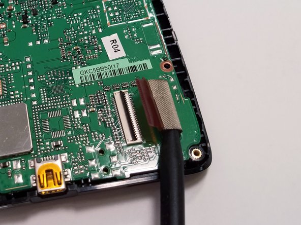

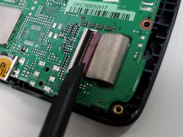

    • Some devices may have a piece of tape or plastic over the ribbon cable latch. If your device has this, remove it before continuing.
    • Carefully lift the black ribbon cable latch upwards with a spudger or other similar tool.
    • Once the ribbon cable latch is opened, insert the pointed end of the spudger, or other similar tool, underneath the ribbon cable.
    • Slowly pull out the ribbon cable in a straight, flat motion with respect to the latch.

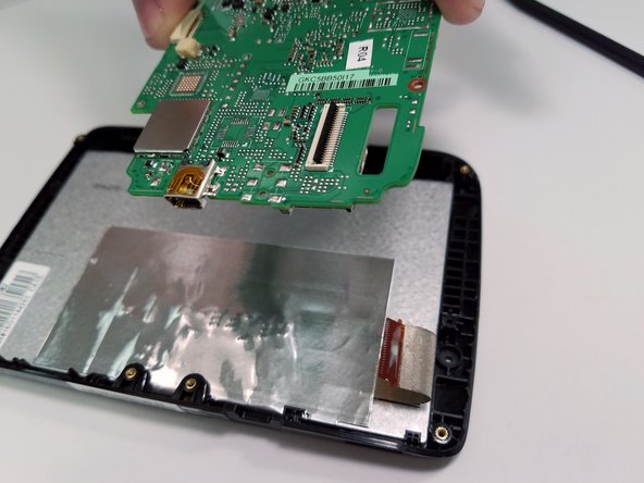

    • Be careful not to touch any of the electrical components on the motherboard as damage may ensue.
    • Carefully lift the motherboard out of the plastic housing by the edges while guiding the ribbon cable through the slot.
    • Store the motherboard on a safe non-conductive surface, preferably an anti-static mat.
