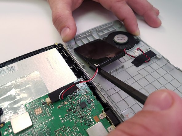

  2. Magellan RoadMate 5120-LMTX Battery Replacement: crwdns2935265:02crwdnd2935265:01crwdnd2935265:03crwdne2935265:0 Magellan RoadMate 5120-LMTX Battery Replacement: crwdns2935265:02crwdnd2935265:02crwdnd2935265:03crwdne2935265:0 Magellan RoadMate 5120-LMTX Battery Replacement: crwdns2935265:02crwdnd2935265:03crwdnd2935265:03crwdne2935265:0
    • Pry back cover off with a plastic opening tool just enough to see where the speaker is attached to the motherboard.
    • Do not fully open the back cover or you risk damaging the speaker wire.
    • Use a spudger to disconnect the speaker connection from the motherboard.
  3. Magellan RoadMate 5120-LMTX Battery Replacement, Battery: crwdns2935265:03crwdnd2935265:01crwdnd2935265:02crwdne2935265:0 Magellan RoadMate 5120-LMTX Battery Replacement, Battery: crwdns2935265:03crwdnd2935265:02crwdnd2935265:02crwdne2935265:0
    • Run the tip of a spudger between the battery and the housing to loosen the double-sided tape holding the battery in.
    • Still using the spudger tool, pry the battery from the housing.
    • If you damage the tape while trying to remove the battery, you can replace it with any double-sided tape.

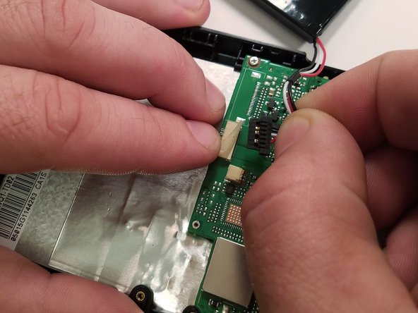

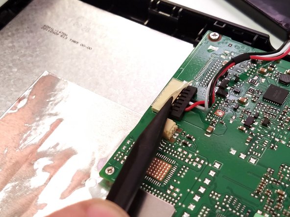

  4. Magellan RoadMate 5120-LMTX Battery Replacement: crwdns2935265:04crwdnd2935265:01crwdnd2935265:03crwdne2935265:0 Magellan RoadMate 5120-LMTX Battery Replacement: crwdns2935265:04crwdnd2935265:02crwdnd2935265:03crwdne2935265:0 Magellan RoadMate 5120-LMTX Battery Replacement: crwdns2935265:04crwdnd2935265:03crwdnd2935265:03crwdne2935265:0
    • Pull the edge of the tape up to remove the tape that holds the battery wire to the motherboard.
    • There is a clear rectangular adhesive strip that also needs to be removed with the pointy end of a spudger.
    • Slowly pull the connection from the motherboard.
    • Do not pull too hard or you will risk damaging the wires.
